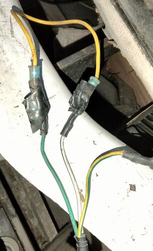

That’s just the microswitch that senses if the brake is set or not. It’s like a $4 part at Mosler or Digi-Key, or free-50 if you just jumper the right two leads together, then the car is happy all the time. I drove mine around with the microswitch jumped out for 2-3 years, it didn’t care.
I may jump the wires like you if I have any trouble with the switch. There are 3 wires (top, middle, bottom), which 2 need to be connected to bypass the switch?
Actually on our cart the parking brake recall, in addition to a new switch, also included a beefier metal support piece and other parts under the seat.
But what if one switch was wired incorrectly? So one would possibly be jumping the wrong wires together. Might work, might not. Might also cause an earth shattering kaboom.
Wire colors at switch:
Yellow/Green
White/Green
Green
Disconnect all wires from the switch.
Jumper White/Green to Green
Cap/tape off Yellow/Green and leave disconnected.
