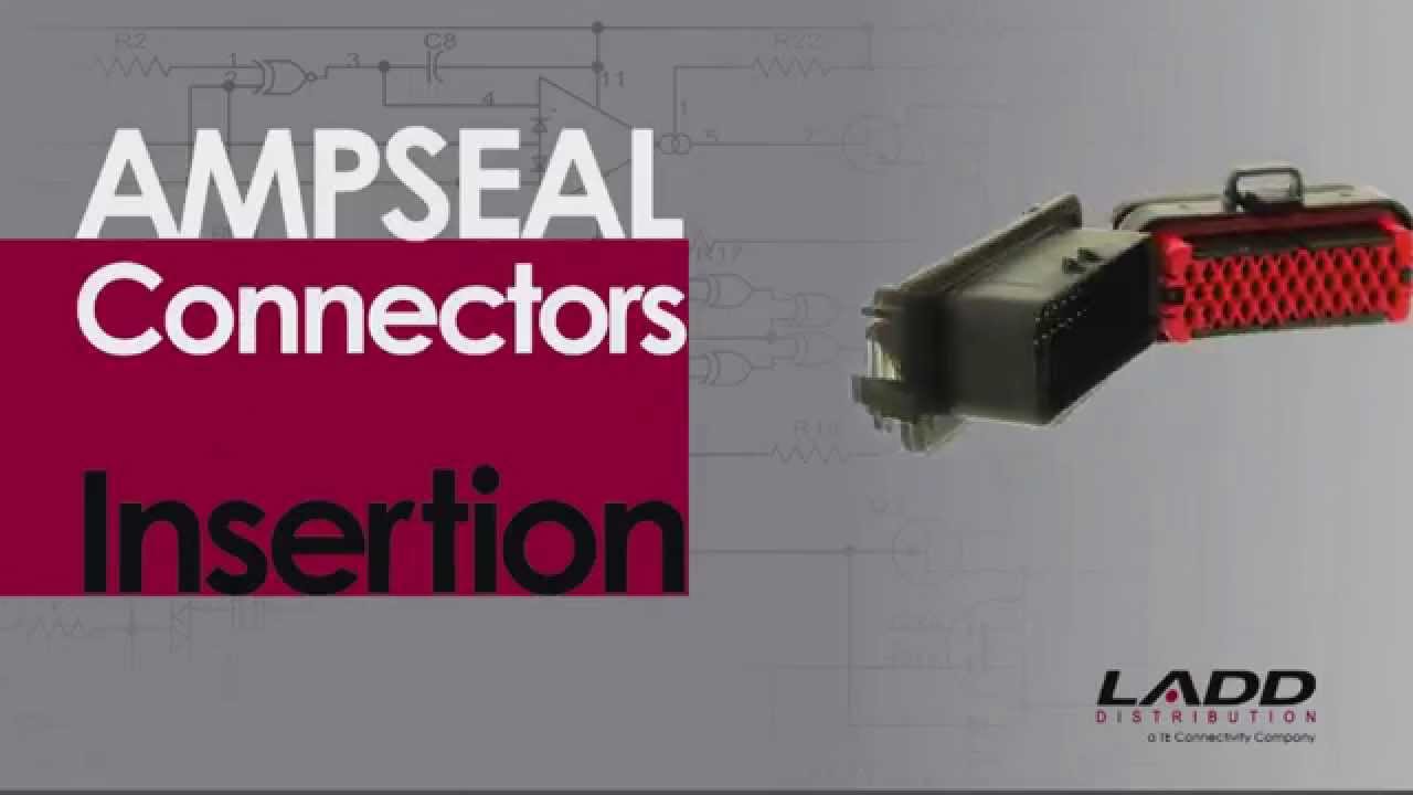

Release the red part that goes into socket.
Twist and pull wire to remove.
Push the new wire in the proper distance, same as others, and snap red retainer back on.
Google ampseal 23p connector for pictures.
David, Awesome info, thanks. I’ll give this a try tomorrow. Also, what is this “spoof” wire for? If I cannot get this wire / pin out, would it be OK to splice this in. Thanks for you reply.

Google ampseal 23p connector for pictures.https://www.youtube.com/embed/K3d2u-a7udQ

Hi David, Could use some guidance here and thank you for the video on the connector. I was able to get the pin out and connect the spoof as you directed. I ensured the number 1 female pin was at the proper depth, replaced the connector and what I am getting is a yellow wrench appearing in the dash and the Gem will not move. I disassembled everything to ensure it made contact everywhere and I did this three times w/ the same result. I took the spoof wire out, re-installed the original wire and the cart run once again. Sorry to bug you but need some of your expertise.
