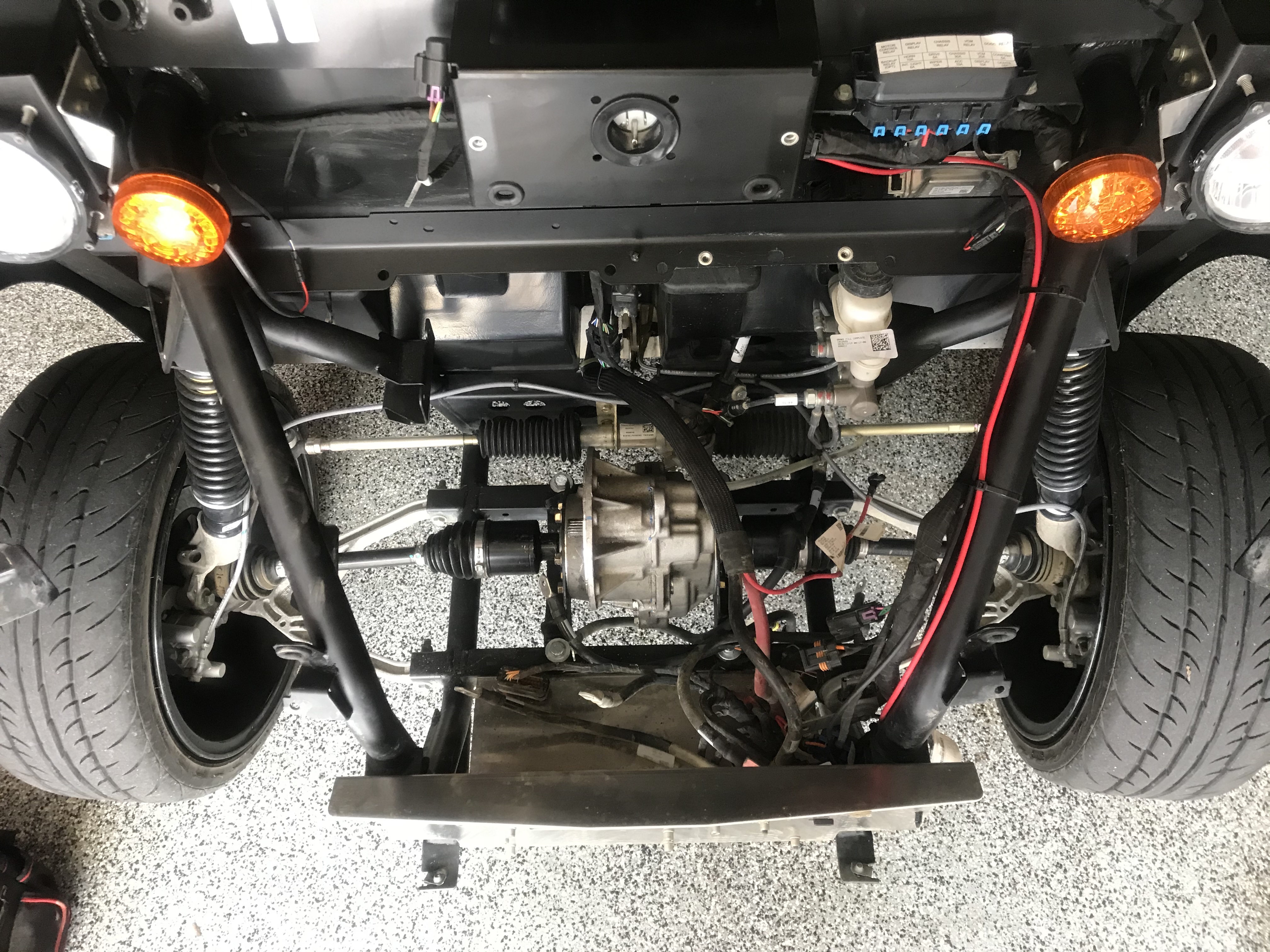

Stay tuned everyone for my posts in the next couple weeks of my front end swap project where I put a complete front end from a 2014 on my 2000.

Tell Grant the correct order of the phase wires.
Did you know, or were you lucky. 50/50 chance.
My hood is on now.
