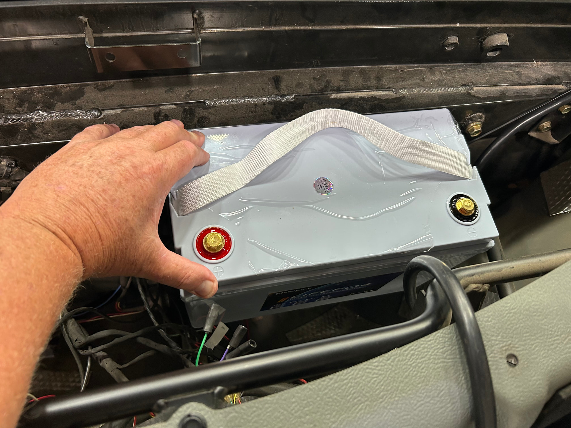

The 100AH lithium battery showed up today along with the charger. Good news the charger Auto Starts. So I’ll keep that! And the battery looks like it will fit. We will see how it gos when the battery tray shows up. Me thinks it’s not gonna fit and I might be able to make a simple strap system and fingers crossed return the Battery tray
this is how the battery will sit in the car
