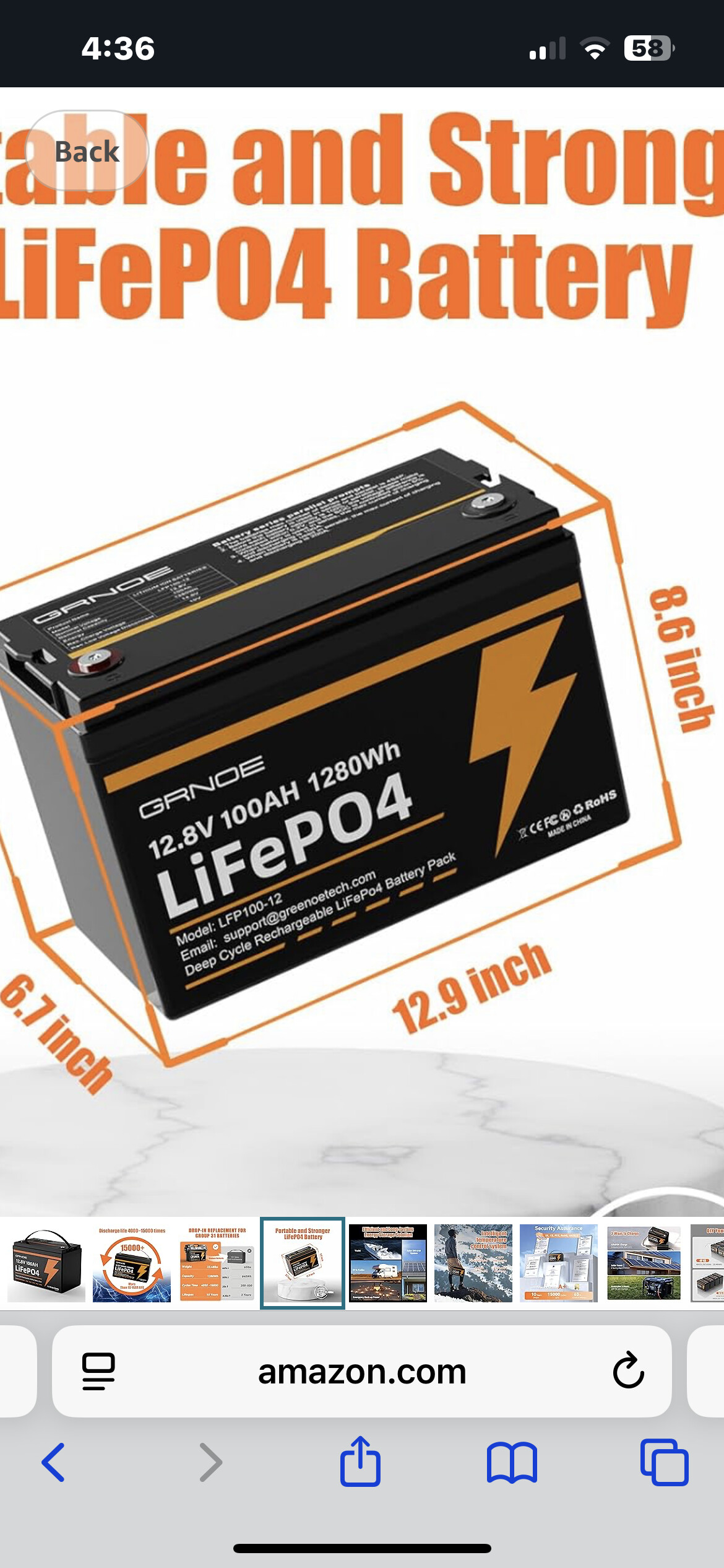

Yeah, I’m leaning towards the battery. It looks like I can get 100 amp 12 V lithium battery for like 150 bucks only weighs 26 pounds and I can mount it up under the dash where the factory 12 V battery used to be this way. I don’t think I’m going to run into overdrawing the power supply. A battery can take a pretty good hit as far as amps go versus a power supply. Then I could just add a small trickle charger to maintain the 12 V stereo battery

On the streets, the hotrod sound systems have dedicated 12 volt lithium battery packs to dump HUGE amperage into the amp when you want to shake the Richter scale. Those packs are about the size of a standard car battery. Do you have room to tuck one under the seat or elsewhere? IF you went that way, you could charge the pack when you charge the cart (separate charger of course). IF you want to get more sophisticated, then get a drop down 72 volt to 12 volt charger, OR run an inverter 72 volt DC to 120VAC so you can run your margarita blender when you’re not plugged into your 12 volt charger for the sound bar battery pack. In a power outage, that inverter can make you a hero!
Yea I’m leaning that Direction. I have plenty of room under the dash. I could put a full Group 31 battery under the dash. Looks like the standard 100Amp Lithium Battery is right around 13inches
