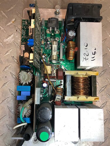

That is a special order diagnostic device that will show you the next weakest component.
And all’yall wonder why it was free…
A bolt fuse. Well, you know supply chain being what it is with all the shortages (no pun intended). American Ingenuity!!
Make sure that is a factory bolt fuse, don’t use an aftermarket one for safety issues.
I was trying to count the threads to see if it is properly rated.
(before I get flamed by the purists I realize there is only one thread)
What if it’s SAE though? Zivans are metric…

I’ve done some more research and it looks like I should leave the Original charger in the vehicle to trick the interlock and get another charger.
I’m kind of cheap so budget friendly will be the goal. I still have a few more months before the camp ground opens so I have some time to send this unit out to be repaired if that’s worth it or even possible? Or should I just buy another charger? Like I’ve said before this is not our forever cart so I have to think about resale and what people might look for. Any ideas would be Welcome
Nah.
Just take the two interlock wires going to the original charger and splice them together if the new charger doesn’t have that feature
Just for your info- You don’t need to leave that charger installed to bypass the interlock.
Where were you getting that?!?!?!?
All you need to do is attach the two smaller wires together. Keep track of them as you will need to pull them apart again when you scrounge your new charger.
I will often measure the AC voltage inside the unit just to be sure there isn’t a wire broken leading into the charger/device. IIRC the Zivan uses a typically shaped connection for AC as you’d find on many computer peripherals(monitors, power supplies, etc) so you can bipass all the onboard wiring and connect directly to the bottom of the charger.
