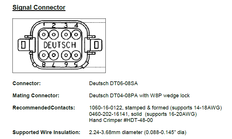

The charger is tested and ready to ship, along with a 300amp 24s bms.
Pin1 white is now “enable” connect to B- to charge.

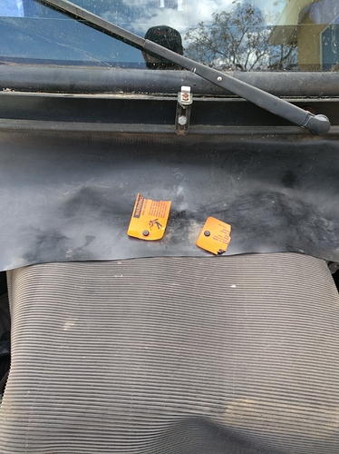

Goes in the car like this.
Brackets screw into the edge of the 1x4 al top cross frame.
Backing between battery and gussets. Seemed like a good idea at the time.
Did you fit it under the rear seats?
If so maybe 320AH pack
Yes, it fits both ways.
This way and stacked. A 24kwh gem may be a 100 mile record breaker.
This is best way for me. I don’t have to break packs in two…
My first two packs arrived separated so I went this way. I have two other packs still assembled. I like having the weight up front though. The wheels still spin if you turn and punch it. What cut off voltage do you think would be safe for the bottom end of a charge on these packs? I ran from 80+ to 73 yesterday. SOC reads 79% but the curve on a lithium is different from an SLA.
I really can’t come up with anything good to put under the seats. I may just put the second battery pack there to make this a true daily driver.
Nothing left under 3.5v Won’t hurt them down to 3v.
