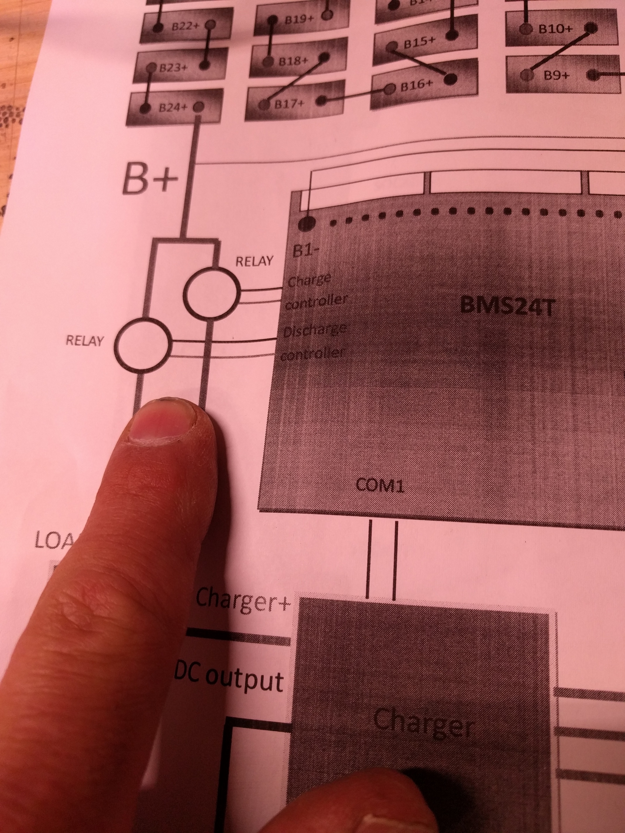

The bms controls the C10325 when connected. I have not tested.
I make a one wire interface to connect bms to DQ charger. My preference.
The Gem has a low voltage cutoff that works fine. Test it to see what the cell level is when Gem goes to limp mode.
Copy that. Are you using the one wire system on this same BMS or the Bluetooth version you mentioned?
Actually it should work on any bms. I make it specific for bms-24t.
The delta-q has a single wire control. Ground to enable.
The bms puts out B+ to enable. I build an inverter and led into a shrink tube bulge between bms and charger.

Set the DQ a little high and change ch level from the bms. 3.9, 4.05, 4.11v whatever you want. The first cell high terminates charge.
Bms will balance and restart. Repeat until all cells are charged automatically.
Pretty neat system.
The bms and C10325 are supposed to do the same. It seems buggy to me though.

Depends on where he mounts the module. I tested and charged the battery packs individualy at 10s with the BMS. One installed and connected to the full 24s I fried the BMS. So yippy. Good news is fuses work. I’m now adding a second fuse in line outside of the pack. Going to need a different BMS myself. What’s your thoughts. Better with the 20s module, Bluetooth set up? Or another 24s?

Copy life getting in the way. Let me know the best way to send you money for the charger/ BMS. In your opinion, better to use the 24s you pictured or another BMS?
Let me know where you’re at as far as equipment.
Are you starting over?
You should only need one charger and bms. I don’t like to give contradicting advice. Everyone has their own opinions.
I have used Chargery in the past and like it. The bms-24t works great controlling a DQ charger.
Going forward, I will use the bluetooth bms because of the fuse issue.
You are past that now. It’s your call. BMS-24t is simple to setup and use, bluetooth on android was a stretch for me.
