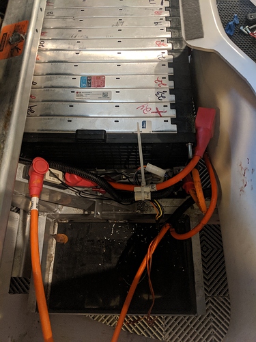

It’s alive !
All in . Have a 1/4" of clearance between top of battery and bottom of aluminum seat bar . Hooked up the balancer and charging now . Current charger setting is only going to 93.x volts for now until I load in the NEW #161 profile . This should charge to 96.7v and put each cell at 4.03v which is perfect .
The modules are a little out of balance , Poor balancer has its work cut out for it on a pack this big .

Been traveling and finally got home today . Loaded the new #161 lithium profile in and am charging . will post finished voltage when it finishes and what voltage spoof that I install . Going in for back surgery tomorrow afternoon , so don’t know if I will have a chance to do a full distance test . Thinking it will be around 60 miles and don’t know if I will have time .
