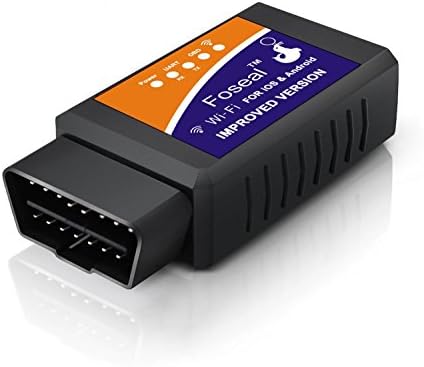

Mike, I just wanted to verify, this is the correct can translator?
Do I need the $20 add-on serial cable?
Do you still recommend the $20 Foseal ODBII scanner w/ wireless to go with it?
That is the correct item from thunderstruck -
you do not need the serial cable
Most any ODBII scanner with bluetooth should work - You need the torque app pro (4.99) to read the ODBII - I think their Andriod version uses bluetooth, IOS may use WIFI but have never tried IOS.

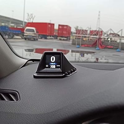

Thanks Mike. I haven’t had a chance to order the can translator yet but grabbed a few related things off Amazon prime day. One of them is this display, I didn’t dully read the description, I thought it was a GPS speedo that could also optionally read ODBI info. It’s actually primarily an ODBII interface (it pulls power from the ODBII harness) and GPS speed is an option.
I’m now wondering if I can use it to display RPM from the ODBII and GPS speed. Could live without the other data if I were to use it in that manner. Is the RPM signal / format universal or is Torque app doing something special? Any thoughts if this could be hooked up? No real info in the box about it, just some sketchy directions.
The torque pro app lets you put in equations that then show the correct value on the screen. Unless that little display let you put in custom fields and values I think you might be out of luck.
Thanks Mike. It looks like all it can do is change what engine data is being displayed, and those come from a pre-set list of generic choices. It’s a little unclear, there might be some fine tuning available to adjust the output displayed, but anything anything more than seems to be beyond it.
Not a big deal. I picked it up along with the GPS spedo that Grant posted, just as an option because it looked like you can mount it on the pillar. Meh. Back it goes.
