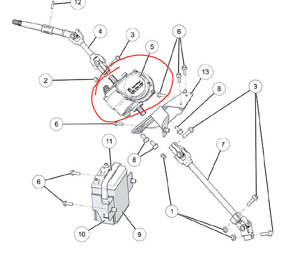

it’s under the dash. take off dash and if there is a black box aroung the steering, it’s PS
Thanks Mike ill check it and confirm now that i know where to look. I’m still waiting for my service manual to be in stock so i can buy it
I trolled around looking for what the EPS looks like and guessed that this is what it was. Not part of the rack itself, but more of an assist motor inline with the shaft.
