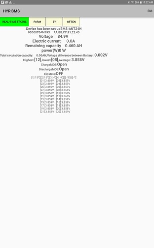

Small on bms switch upper left of bms.
Two temperature sensors connected. One middle of pack and one on the series connection right end of battery.
Bezel on LCD for mounting in dash.
Two extra sensors in bag for ???
Now I need to build another one to sell. This one got too big and expensive, so Iāll have to keep it for myself. Now 39" L x 15" W x 7" H
⦠Anderson B+
