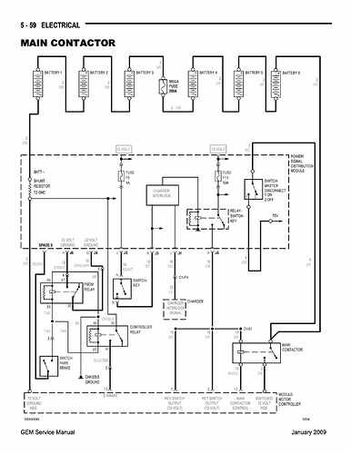

Lots of friends have tried to get it running, with no luck. Finally brought in a professional today. I had a manual, with some wirining info, but it lacks detail on the hand brake relays. Does anyone have a wiring diagram with info on what it should read, 5 volts? (The orange wire with black stripe)

Yes, if the handbrake loop is active, it will light up the brake light on the dash and the car will not move.
I find it curious that you mention that “clack” (main relay closing). This is a good sign that the controller is ready for pedal activity. Whatever you did with the handbrake means it is OK.
Do you hear any high pitch whine coming from the motor?
The Orange/bk wire is actually B- (-72v). It is switched by one of the twin 12v relays mounted up on the front wall under the windshield. This relay is triggered by 12v coming in on the tan wire from the hand brake. This relay sends B- to Pin 13 on the controller which clears the hand brake alarm.
The other relay also uses the same 12v (when hand brake down) to make/break B- on a loop coming in/out of the PSDM to sound the steady beep when KeyOFF (so you do not walk away without setting the brake). The steady beep also helps locate your car when it rolls down the hill and tucks neatly out of sight in the neighbor’s ditch.

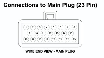

If this issue appeared AFTER people have been poking at it, then it is probably directly related to them trying to help. The guide steps through direct probing the 23pin connector going up to the controller. Depending on the tools (meter probes), when jammed into the connector pins (looking for electrical gremlins) it actually damages the pin/sockets to where they make flaky contact when jacked back into the controller.
In this case- Pins 7, 8, & 9
Test this:
With -21 dominant on the display push/pull the wire harness one way or the other to see if the error clears. Else, pull the 23p connector and give it a spritz with electrical contact spray (if you can find some down there) and reinstall plug with a wiggle skritch until you hear it click when it locks into place (I don’t recall if a KeyOFF/ON cycle needs to happen to clear the code or if it will clear itself when the problem clears).
Pay special attention to Pin8 (which is B-)(-72v). Ref B+.
(Note: I have conflicting diagrams that some cars may have B- on P9)
Test this on the controller plug with MainBatSwON, KeyOFF.
Pedal Plug pins
Follow all this? Report back with what you find.

I (personally) have issues with the troubleshooting guide.
In this case- Special attention to Pins 7, 8, & 9
Still getting error 21. The latest mechanic did actually get the car to move on Friday. But then on Saturday it would not go. Wiggling the main connector on the top of the computer sometimes gets us a clack
This is exactly what I needed to hear from you 6 mos ago!!!
Your problem is in the loose pins.
You (or your mechanic) need to very carefully disassemble the 23p connector and re-tension the little wipers on the female pin/sockets. They are very small and delicate. Old eyes would benefit from magnifying loops and good lighting.
Female Pins look like this:
3 wipers per pin need to be pushed inward to make better contact/grab on the controller pin when locked together. Use a pin or a dental pick
This is not an easy job and you must be accurate and precise. Take your time.
Then never allow anybody to jam a probe the 23p again.
