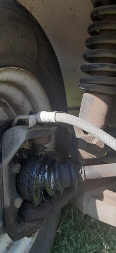

Good morning I have a 2002 GEM E825 and over the weekend I noticed the passenger side axel boot was split. Does anyone know if the sell a replacement boot?
Yeah… it happens. I’d say you did pretty good getting 23 years out of the ones on your car.
CV’s are a tricky repair. They are a PITA since you need to knock most of the front end apart just getting to them. Once you get them on the bench, you need to strip the axle down and clean it out real good. It is a messy job and takes some special tools to make the job easier.
This also assumes your original Cv’s are still in good shape to use.
Depending on your skill set and talents, this may work for you.
Some people find it easier to order up a complete half shaft assembly and call it a day.
There are quite a few How-To examples over on YouTube Universitiy if you want to see what you are getting yourself into.

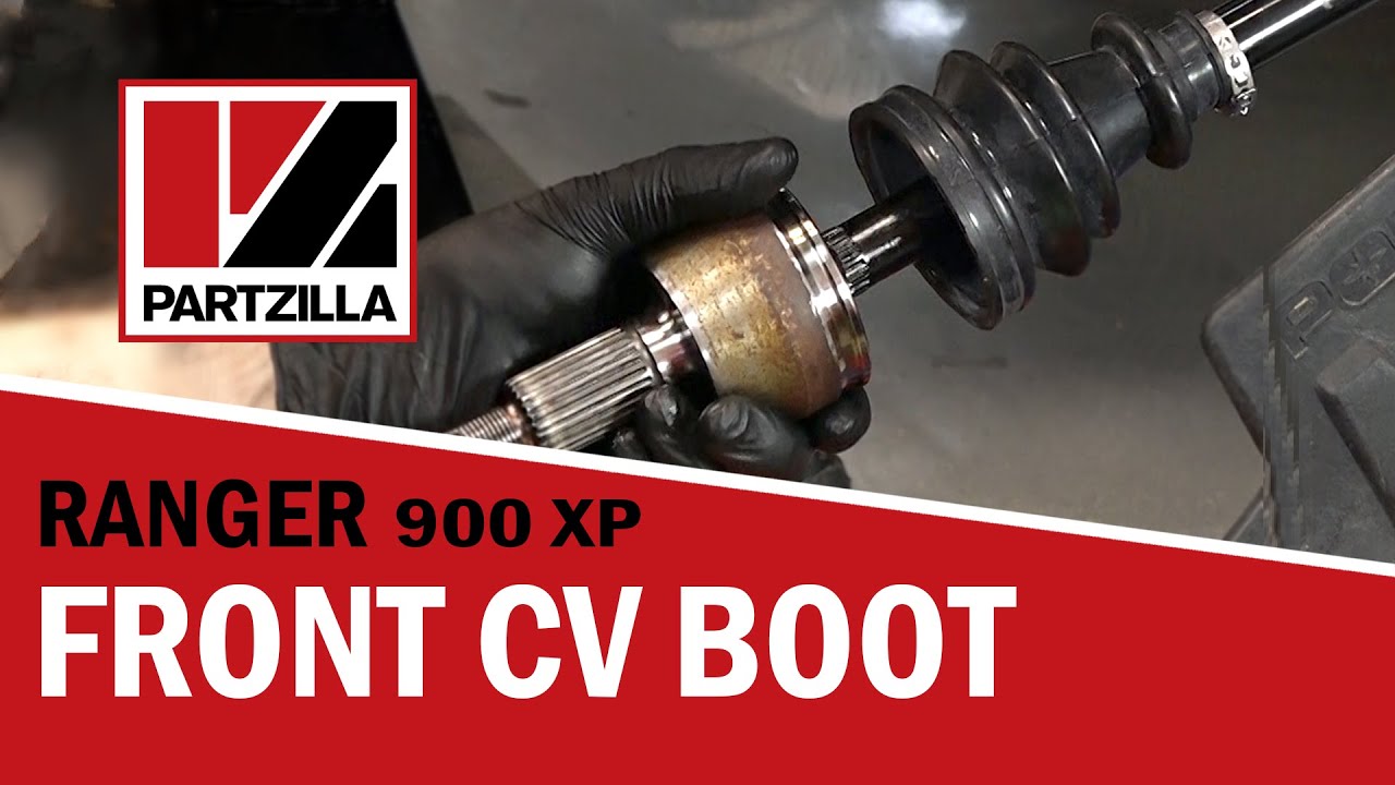

Here is one that shows how to do it on a SxS (fairly close to how it would work on a Gem.
Note that this video shows the outboard CV sliding right off. I believe the Gem uses a spring clip retainer that must be dealt with to remove it from the axle.
