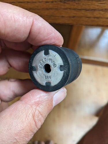

Has anyone run across these on the interweb? I have a 2002 with the rear seat rubber socket/cup crushed and I have two rear doors which won’t stay closed because of cracked rubber socket/cups.

Turns out that the door holder rubber sockets are ~1"h x 1.25"diameter and the seat holder rubber sockets are 1.5"h x 1.25"diameter. I’ve not found any yet at 1.5"h but have ordered the 1"h units from ebay.
I found the name Eberhard embossed on the hard plastic intert on the door and from another search found the vendor site but have yet to find the 1.5"h rubber piece. Door Holdbacks | Eberhard

Swing and a miss on the ebay link. They were 1 3/8"h x 1 5/8"diameter. Doors need 1.125" h and about 1.25" diameter. Sent an email to sales@eberhard.com to try and locate the correct size for both the GEM rear doors and the GEM rear seat. The seat ones are ~2" high with same diameter.

Considering everything I’m finding online points to them being the same DH38 or DH39 design which have the same rubber component just a different length plastic insert part. Even the ones on the Eberhard site, 4 of them all point to the same 1.5" diameter rubber part. So the likelihood of the marine or RV store having the smaller part is slim.

Well, the manufacturer of the part, Eberhard, is telling me they only manufacture door holdbacks which are 1.5" in diameter. Part number 1-666-2 would probably still work for the doors on the 2008 but will not work for any of the rear seat holddowns.
There is a plastic cover I can open up to get the doors to hold a 1.5" diameter holdback but the seats have a thick metal bracket the holdback protrudes through.

I found the ones for the doors( 1.25"diameter x 1.00"height) @$7.xx each:

And I had the seat bumper measurements incorrect, they are 1.50"diameter x 1.30"height and those can be found all over the web since they are the same used on RV doors. So the 1-666-2 model is probably the one for the seats.
OMG, if only the Eberhard sales people had mentioned that the part number was stamped into the metal plate of the rubber socket…
