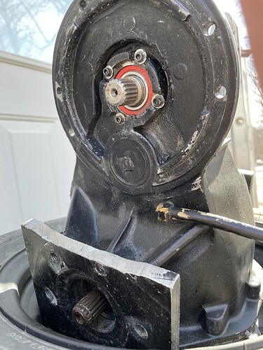

Here are the Output shafts 22 Spline
Here is the Input Shaft 19 spline
Let me ask my question again so it makes more sense. Could we take out the Output shafts from the factory gem transmission & put them into one of the 8.1 transmissions.

Looking at them, i dont believe they are the same.
Rodney, can output shafts swap?
18 spline and 22 spline.
