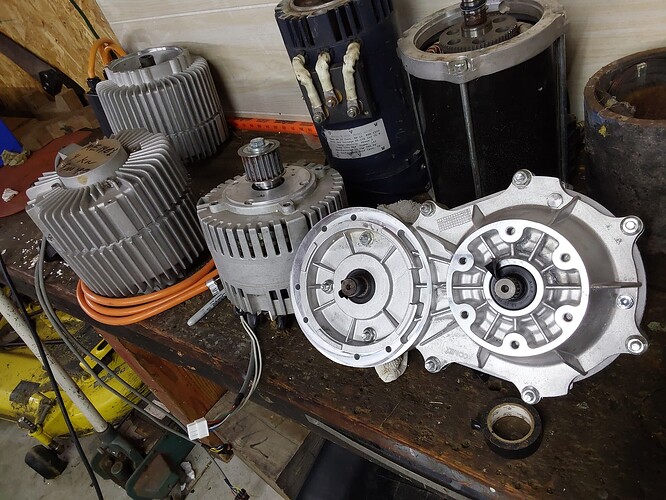

Brand new ~8:1 gearboxes available.
@djgabriel2004 , how many are left? Is it worth looking for shafts for these?
Looks to fit new Gems with the correct shafts.

Exactly, sample here is about 8:1 but there are other ratios.
The only difference may be the output shaft and bearing caps. If any.
Do you suppose a gear is integral with the shaft? Deal killer. Rodney would know. Do you have a picture of the Gem outputs.
