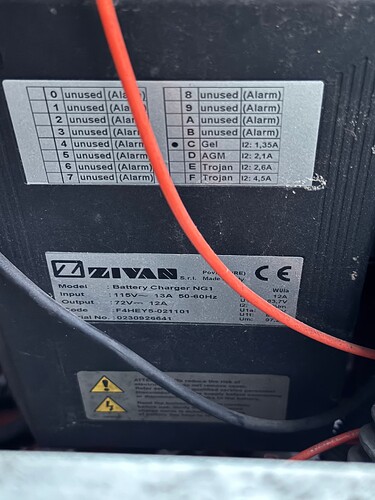

Hey, does the original charger work and is it a Zvan or a Schott?
If you put flooded batteries in, a zivan is fine. Even other chemistries will work you just need to rely on your bms to halt the charge.
If it’s a Schott, it’s garbage. Depending if you have a late or early 02, will influence which charger it has.
As fot the trickle charge, some have automatic 7 day restarts. For those that dont, the way around that for the zivan is put the car on a 15amp light timer, have it cut the power once a week for 5 minutes then turn back on and the charger will kick back on and top off the wet cells. Make sure they at the proper water acid levels.

@Djnasty - Yes, It would be good to look under your dash and identify your charger. A big black plastic box dead center of the dash will probably be a Zivan. If silver(aluminum), then it would be a schott.
Do you have a hand held digital meter? With that you can monitor your battery voltage when it is charging. You need to see how kind it is to your new batteries.

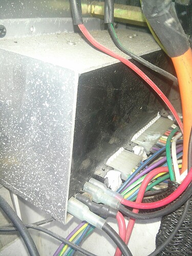

Looking around in under the dash, over on the right side, way down at the passenger foot well, you might see an open faced circuit board. (much like this)
Or even an aluminum box with black end cap.
These are two signs your wiring/recall has not been done.
It is not necessarily a BAD thing if not done, as long as the board down not look like it has been compromised by moisture (all corroded and dirty).
If your recall has been done, you will have a black box with fins. This box will even have a label marked SurePower on one end.
If NOT done, There are not any dealers I know of that will perform the recall. Best bet would be to watch for someone parting out a car and grabbing the harness from them.

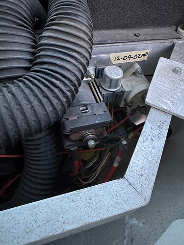

I am sorry for the delay… photos below of what I am working with… haven’t charged the batteries longer than a few hours.. so not sure if the system would turn off or not.. currently running the charger on setting E.
@JarJarJava @AssyRequired
I am sorry I am such a rookie at this stuff. Not even sure what to ask the community for lol to upgrade to the better stuff
I do have access to 2 seater E825 photo below. Would that black box to the right swap right over? Would that solve my potential fire issue?
