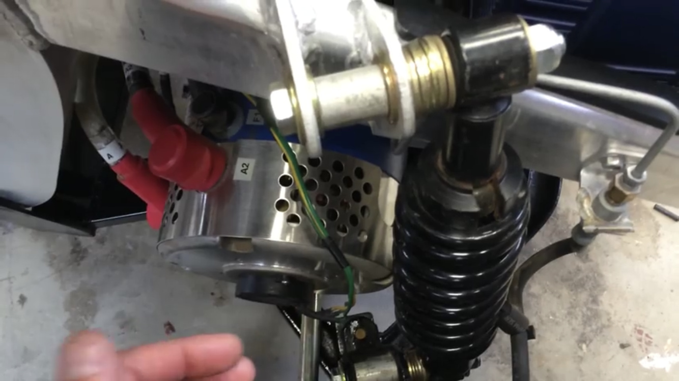

I like the shocks I ordered but the arm holding the Canister does not fit in the top mounting bracket. So I had to install upside down. I am looking for the same type of shock now that doesn’t have the side canister.

Only thing about extending the top mount out it would change the angle of the shock to angle inward instead of outward.
Here is a cheaper option that would work
Look at my pic. You will understand the angle of the shock would drastically change and not sure how that would ride
