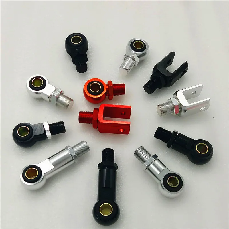

This is why I was thinking about these (12mm coil, 72mm wide, 6ish active coils, 325mm eye to eye) - You can also find the same shock in 330mm and 340mm
https://www.aliexpress.com/item/33012191586.html?spm=a2g0o.productlist.0.0.5631760c3apPw7&algo_pvid=b352da10-7891-4df3-a16f-bf266383af2f&algo_expid=b352da10-7891-4df3-a16f-bf266383af2f-27&btsid=e2a6252d-27ca-4ea4-9439-1bf60d1f5c11&ws_ab_test=searchweb0_0,searchweb201602_7,searchweb201603_52
Pressing in 12mm bushings found on the same website (new shocks come with 10mm, GEM car shocks are 12mm)
And buying a pair of these if the result is a little too short

Glad to see there are more people on here having the same trouble. The shocks I purchased were 320 with adjustable to go up to 330. I did adjust those from 320 up to 330 as it help the camber of my front wheels at standing height. I did take a level to the wheels to get the right height. So honestly the adjustable Eyes are great for the Camber. In the end the shocks were just to soft and the front end of my cart collapsed when taking it out of the garage.
