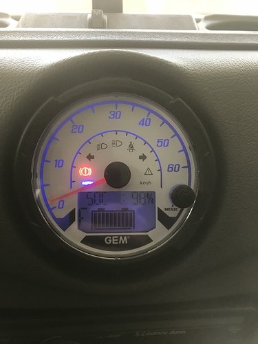

To add to my list of new GEM issues , Sunday morning when I attempted to pull GEM out ( w OG 2018 speedometer ) for a quick test drive I noticed the Red brake indicator illuminating after e-brake was realeased with zero drive or reverse power.
  • Saturday’s testing the newly purchased 2016 speedometer w no power or response, traveling back and forth less than 4 feet and immediately reinstalling original 2018 Speedo somehow alarmed my brake indicator warning light ON full time. Currently stopping the vehicle from any present movement until this unexpected issue is reset. In addition,I cannot find anywhere on-line with a similar issue and reset procedure.

Thanks for the time and response, sounds like your busy busy. Mike, i don’t know what direction to go with this new discrepancy. Why would a easy plug and play speedometer install take my ECU down?
Last Saturday driving the GEM as normal before install, performed install of purchased speedo, car still moved forward and backwards but zero power to speedometer or needle response. Removed purchased speedometer (not working) and reinstalled original but now brake indicator light illuminated. GEM car is now stalled ? i was hoping it was a easy fix without having a GEM serviceman coming over and charging a bundle.

Thanks, No wrench indicator illuminated just the red parking warning w/ the e-brake set or released
It the weirdest thing i’ve experienced. Literally drove that morning. switched the speedometer and switched back to original noticing the parking indicator not resetting

Captured this photo 1st w parking brake off, unplugged Main disconnect just now.
