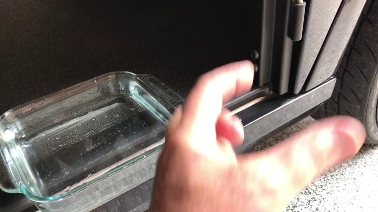

My 2017 has live outside it’s entire life b4 I rescued it and now it lives indoors, along the way I have noticed when I switch from forward to reverse or change directions I can hear water sloshing from one end to the other. The aluminum box frame seems like a likely suspect so I Drilled a whole in both of the frame rails so water could escape. Well nothing. I don’t have a window washer bottle so that’s not it. And my car is lithium

On the water issue… I have found water in the aluminum frame, there may be two walls in the aluminum channel ( maybe you only drilled through one? )

Hey Walt I checked. My square aluminum tubes. Unfortunately they are not like yours I ran a long drill bit threw and checked
Um, glad to know you weren’t hallucinating . Stupid that Gem doesn’t know about it . Thanks for documenting .
I would suggest that you plug the drain holes. I’m not sure if you have to worry about it in your neck of the woods but I’ve seen many vehicle frames rusted out from all the sediment/road grime accumulating inside and holding moisture.
