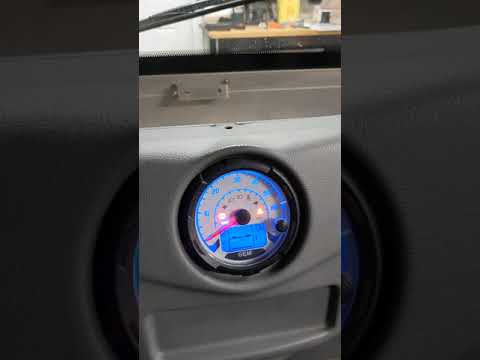

Got some videos. The first one is with the blue wire tapped into the red/switched side of the key switch. Turn it on, the SEVCON comes to life and I get a solid green on the status indicator. I get a battery low indicator and the system seems to power off and reboot every 1-2 minutes.

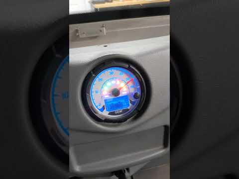

Here’s the the blue wire disconnected. Obviously the Sevcon does not power up, but I get an expected high voltage and the car stays powered on.
