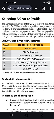

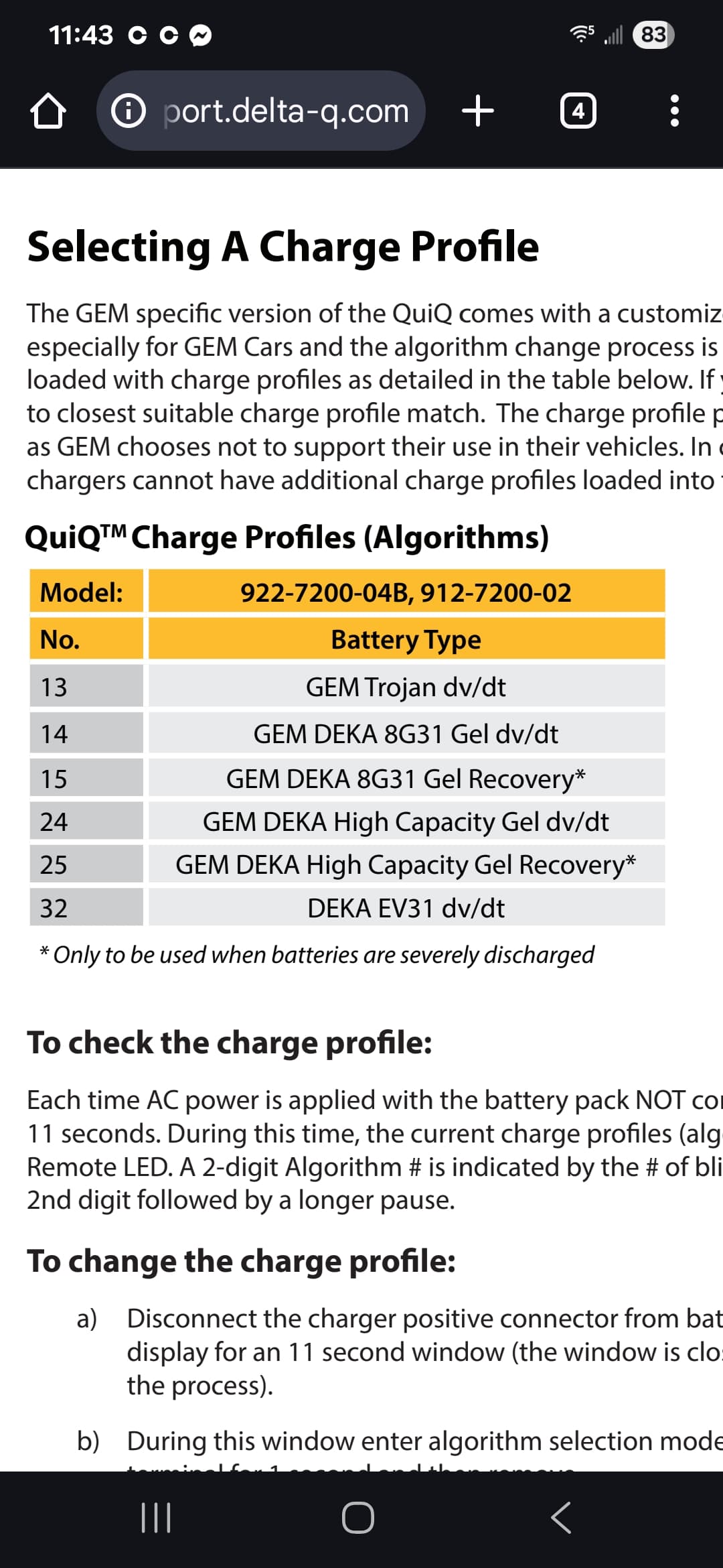

So it will charge at this flooded rate,but it doesn’t show them fully charged when completed. I also replied about what I see when connected to the charger. It has several gel settings, and 1 flooded setting. I can remove them,but can’t add to it
Sir,I responded to your question several days ago. It shows 6 profiles most are gel deka,and 1 or 2 flooded algorithms. Do you want an actual picture of my screen or what? I can tell you that these algorithms are definitely from gem car.

I sent to him also. This is exactly what is in the charger. My computer shows exactly the same thing
