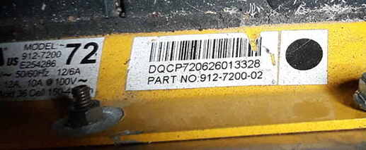

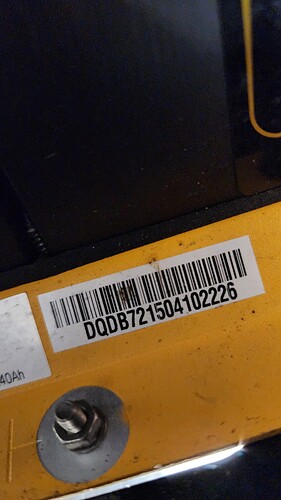

What Serial number is your charger? Hopefully it starts with DQCP with a black dot or later.

This will tell you if it’s a Polaris or generic charger. Also need to know what sw is loaded.
