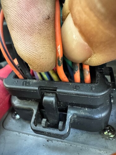

Everything acts normal until I press the gas pedal and get a code 05. No clunk sound from the clunk sound maker. Hot battery leads at the PTSDM read 79-80v. Where should I start diagnostics? How to check the go-pedal potentiometer?

Stick a pin in p3 wire insulation at controller. Should be over 2.4v. Goes to zero volts when pedal is pressed.
Hall effect throttles rarely fail. Unplug and reseat controller and throttle plugs.

As Inwo has pointed out, Remove and inspect the Main Harness 23 pin plug on top of your controller (special attention to Pin3), Reinstall and give it an extra push to make sure it is firmly seated. Try pedal press again.

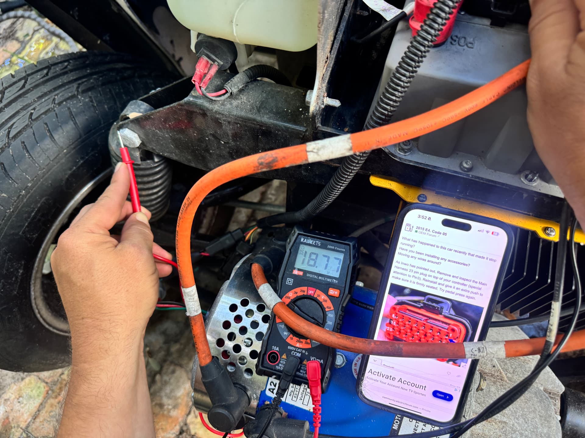

I tested pin 3 at the controller. In the pic it shows 18v. No noticeable drop with the pedal pushed in.
Bad accelerator?
Pin 3Not a valid test. Must test from B-.
Is that from a battery? I tested from the - 72v pole on the psdm and get less than a volt. .15v and .20v pedal down.
You might not have pinned into the wire enough.
Measure against B-.
If you are working inside the cab the most convenient point would be The PSDM (as you noted).
If you are working up front (under the hood) they you have a B- right on top of the controller.
Try this test again. As per Inwo’s instructions:
→ Stick a pin in p3 wire insulation at controller.
I’m getting no voltage on pin 3. If I set it to test 2v I can get .15 and it goes up to .2 with the pedal depressed. Consistently.
