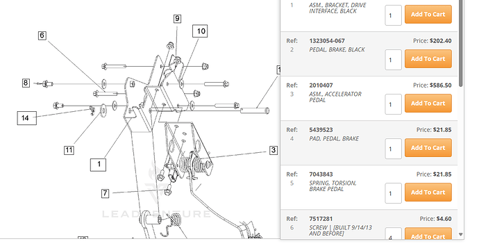

Any suggestions where to get a throttle?
Pedal press does not clear -11? Key reboot does clear -11?
Price one at R4F. Also at a big Gem dealer such as Oscar in Fl.
Gem of Miami parts .

r4f sells the pedal for $600+shopping. I tried to order from cart mart about $100 less but no confirmation yet. Used on eBay is $400. I may go that route.
[See private message]
Let me look again. I hadn’t found one.
Aha, you searched by part number. working,Part #: 2010407”
Good find.
