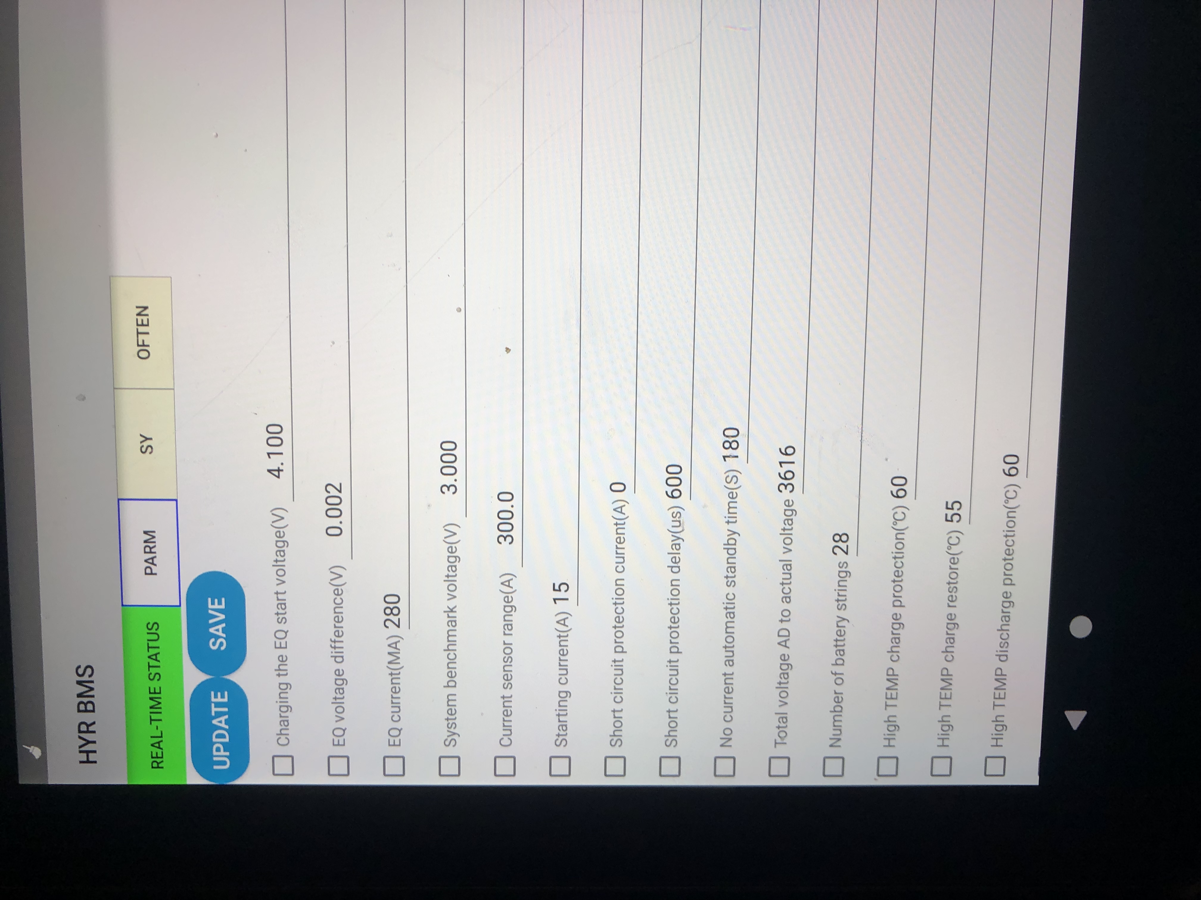

Yes, it comes set for 32 x 4.2v cells.
See if there is a place to change default to lithium iron.
Else change each setting to what you want.
Most will be labeled good enough to see.
I’m looking at settings side ways until I get on my pc.

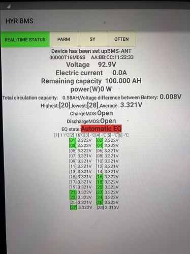

First one is hv alarm. 3.7 or so?
Low alarm 2.5?
High protect turns charge off. 3.55 or so.
Ask if you don’t know what they do.
Total high volts is the highest you want to see. 3.55x28?
No right or wrong.
Thanks Dave, I think I’m getting it. Should MOS charge be on?
I think that’s a different screen. To turn on charger manually.
