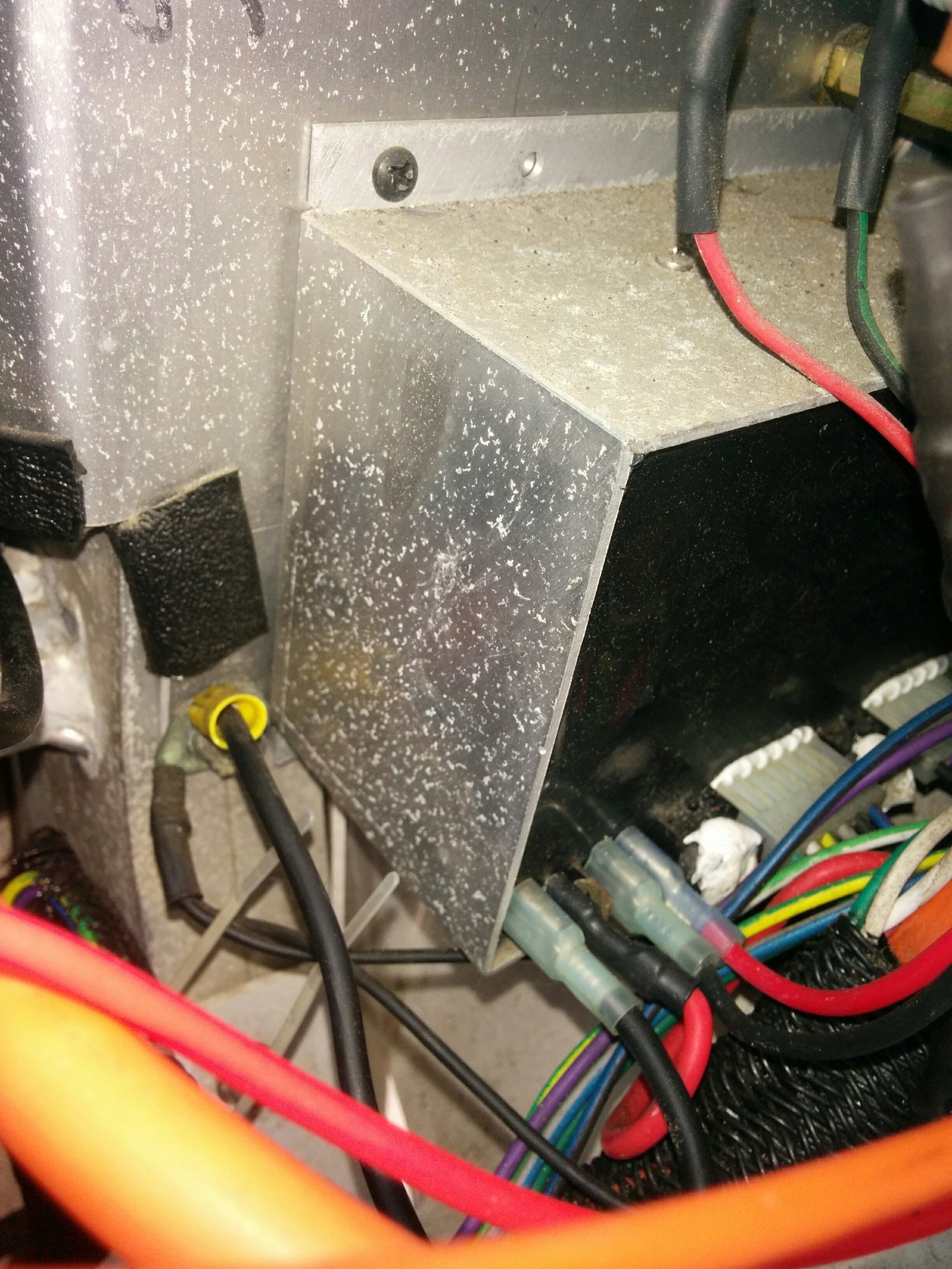

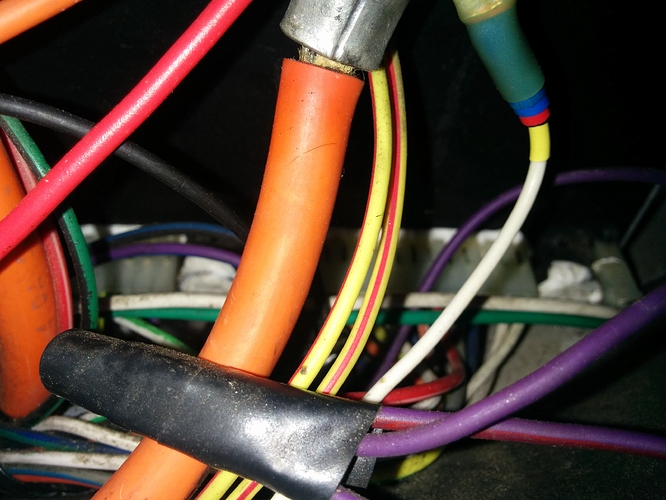

UPDATE: Looks to be the green(72/ground) and white(72V source) wires to the DC Converter.
story: I left on vaca for a few weeks and then tried to take the 2002 e825 GEM out for a spin but could hardly get out of the driveway without a dozen -11 codes being thrown. Took the dash off and as before, I applied the brake and a little throttle then smacked the contactor with the rubber handle of my screw driver but no -11 code. Smacked the lower right dash compartment and got a -11 code. Repeated and same results. Started testing by touching converter wires while motor was loaded and got -11 codes with slight pressure on the green and white wires which are under a little strain on the far right side of the converter. The strain is from the heavy wire-harness loop between the converter and the controller as it’s not supported anywhere in the middle of the dash/firewall.
I tried to remove the connector(P1/P2) but couldn’t so I just wiggled the connector and wires a little and retested. I could not trigger the -11 any more.
Drove for 2 miles on semi bumpy roads and no -11 codes. The wire harness loop touches the firewall so I placed a 1"x2" block of wood between the two and relieved strain on the controller connector and the converter wires.
