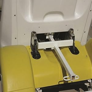

Ok i going to build me a hitch for my ES…does anyone have a hitch on their ES that they can take a pic of …i have all of the stuff to build one but i need to see how far down the receiver is below the bed…i want to make sure i have room for the tags and also maybe not look too bad from the rear…
I’d like to see how you do it… know you’ll post photos… I found some photos… the hitch on an eS… a chrome receiver on an eS… and the hitch from GEM for 250 dollars… not sure how it would attach… you could always put hinges on the license plate if it hangs below the truck…

How much does the bed overhang the trailing axle? On my E2 I bought a hitch mount receiver from Harbor Freight and welded it to the trailing arm. I use it to haul my honey wagon to the dumper. HF has a pretty big selection of towing accessories and they are cheap. I paid $13 for the one I used.
I used this…
I removed the bolt, turned it upside down and welded it on. It sits just under the fender as mine is slightly lifted to accommodate the 16" wheels. It even has a loop for a rope and such.
I also considered this…
Which may work for a truck version as it is longer.
Brian you welded to the axel
Yes sir. The only other option is to drill and bolt to the aluminum channels under the seat. In the last pic you can see a portion of the “grab” handle on the axle. I cut it off so I could mount the hitch in the center.

As far as bending the axle… what do you plan on hauling? I wouldn’t recommend a lot of weight due to wear & tear and the fact that Gem car brakes are minimal at best. I am currently hauling about 300lbs with mine but thats not the weight at the hitch as most is on the wheels of the trailer being towed (much smaller lawn trailer). It would also handle a bicycle rack nicely. You could add a truss to the axle but remember those weak brakes your dealing with. Even if you bought the ready made one which connects to the aluminum frame I wouldn’t haul too much weight.
I am not real familiar of the underside of the truck version GEM, but the ad you linked to would probably work if you cut off some of the excess stuff. You may be able to get the parts new from HF for that money.
