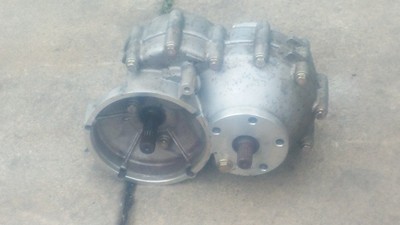

This is a Polaris a.c. motor with a think trans
10 1/4" long
Would need trans shaft retainer flange relieved slightly and holes drilled and tapped in motor bell to fit trans. Bolt circle seems correct but only one bolt lines up.

This differential?
They only made the car one year right? Then I can give the differential and the motor housing to a shop and say… make these work
Ok… I put a bid on that ebay differential. See if I get it. I’ll make some calls on the machine shop tomorrow.
