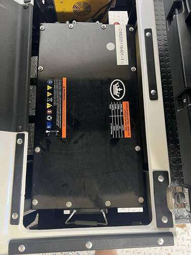

The reason I ask is recently I bought a bad Evolution battery pack for $800 on CL. The MSRP from Evolution is $4.35K) The guy disappeared. It had impressive stats 48V 205 Ah with a C rate of 2. (400amps for 10 seconds, 205 Amps continuous). It had one bad cell. Unfortunately, it had laser welded busbar terminals. I was unable make a good permanent solder connection. Additionally, the pack you build is limited by the capacity of the weakest cell. Meaning a new battery that has a higher Ah capacity would not be fully utilized. Plus I could never get the old and new cells to top balance. So, I ended up replacing all 15 cells with cost of $2250.
I’m in it for over $3k which is way more than anticipated. I keep telling myself that I’ve got a 205Ah 9.84 Kwh, 2C (maximum discharge of 400 amps) pack. Which is a better performer than I can buy elsewhere. Am I just fooling myself?

One thing you might consider with your Evolution pack- What BMS does it use? and you might want to replace it. It sounds like it wasn’t doing a good enough job.
Leave it to AssyRequired to make me feel warm and cozy about shrinking my wallet on a learning experience. The BMS brand that came with the pack is unknown. It only broadcasts when it is charging. (Is this usual)? It sends out blutooth signal, but I can’t connect with Iphone or Laptop.However it does seem to keep cells balanced when I check each cell voltage individually.
I am using the standard DQ charger with an algorithm that is generic for lithium batteries and has a charge limit of 52.4 volts. ((max charge Voltage for the cell pack is 54.75 volts).
It seems that at the end of charge the BMS shuts down the pack which shuts down the DQ charger and then throws an error on the Speedometer display. I will likely change out the BMS since I am “blind” without a blutooth monitor once I put the battery tray cover back on. Thanks for your input.
