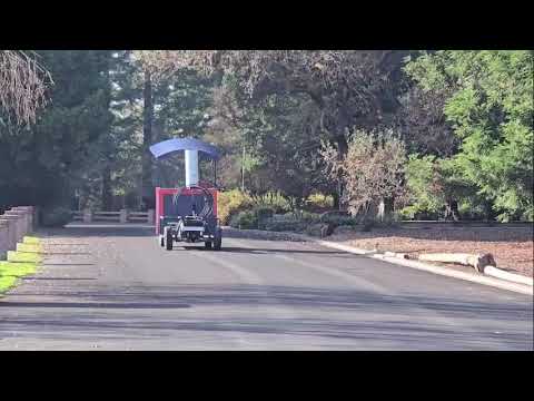

Finally got a video. I also received that bumper today. such a tiny thing it is… ha ha…
here is that video… finally got it out of the shop https://www.youtube.com/watch?v=JCVjm7No3uQ
So what was it ? After all…
That does have quite the howl to it.
Did you try the heavier oil in the gearbox?
How is it at parade speed?
If a person had TONS of free time, it might be interesting to pull the input shaft, clean it, and put some dychem on the teeth to see where/how it is contacting the intermediate gear.

Parade speed works fine but still has noise… just not as loud… livable because of the music.
Ok I stand corrected. No rubber bumper is gonna fix that. That is Gear whine like I have never heard before That’s a Serious Fail in my opinion, Stupid question. Are you sure your gearbox has oil in it

I was shocked that your vid shows you can be heard coming from a block away!!! What is it like riding in your car/train? It’s like those are straight cut quick change gears from a V-drive!! Your camera person cut off 3 seconds too soon. I wish it caught the rest of your neighbor’s “It makes alot of noise” comment.
I don’t think this sounds like bearing noise, but maybe? If so, use a stethoscope and listen to various parts of the case to isolate which one is loaded. That thing is ringing so loud that you may not be able to actually tell which part is the worst.
Thicker oil should help tone it down a bit. You can hear it bouncing off a little lash and going quiet for a microsecond when you were slowing down. If this were in a normal cruiser, it would be far from normal/acceptable for street use IMO. Your only save will be that this is going to spend it’s life at 3 mph and covered by background music. You may need to hot foot it back to your trailer after the parade.
Get it up on stands so you can run it in place. Run it up and down a couple times before you change oil. Then after. It might give you an idea if you did any good without getting it out on the road. Maybe drag your brake a bit to load the gears a bit.
