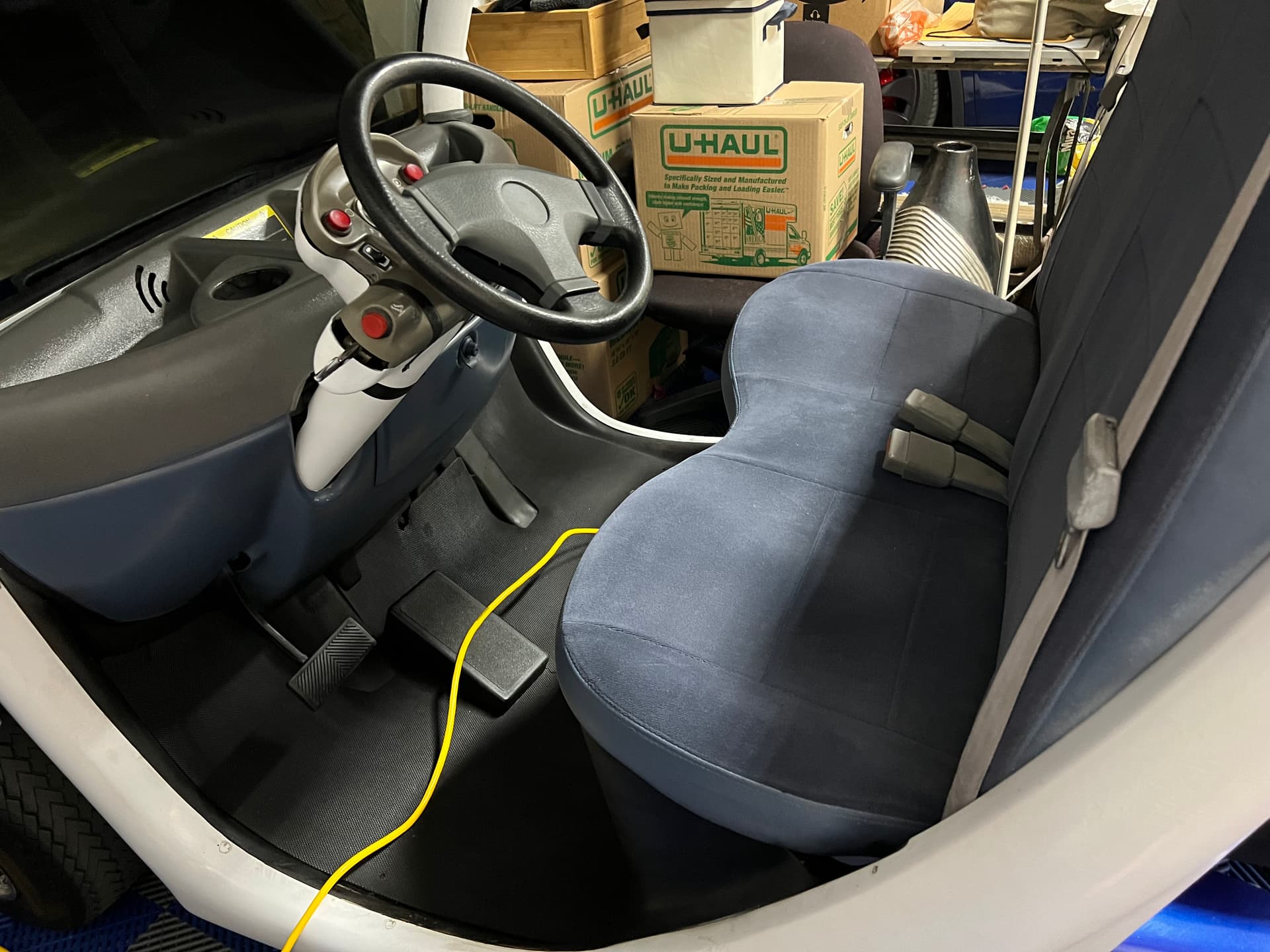

I just purchased an older, seemingly fully operational GEM 2-seater and would like to learn how to maintain and repair the car. Batteries (4) have a 1/21 date code. Charger seems to be working. All lights, horn and motor are operational. I see a serial number on the front under the hood but no model number. I ran the serial number through a Polaris vin checker to no avail. Where should I begin to locate a user manual so I can begin to understand what I bought?? Thanks for any direction in advance!

Is this perhaps an early Trans2? (creatively re-badged as a BMW) Show us a pic of that ser#

Also seems like the Display was replaced, can you post a picture of the electronics? Wondering if still has the original speed controller

- it is in fact an early trans2. According to the serial number it’s number 304Processing: D5B2AFB6-C746-4065-9E19-C15BA628EB40.jpeg…

- found the battery to have very loose connections and the horn was inoperable. Everything else seems to work so I repaired the horn switch and tightened up the battery connections. Also checked tire inflation and charged the batteries.
Attached are some additional pictures and I welcome further assistance and comments!
