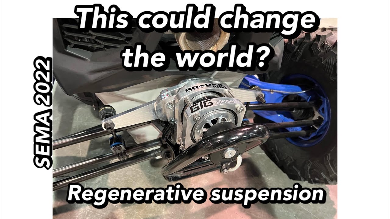

A company that was displaying at SEMA this year had some sort of suspension RE GEN contraption. As the suspension would cycle it would or could capture energy and recharge your battery here is a video of it in action
I wonder why it still has shock absorbers. This thing should be able to do the dampening. Ok, they just got to that. I don’t think they would want to dampen on the spring recoil since you want your wheels back on the ground fast and with the shocks it’s double dampening the recoil.
But cool idea and if they ran out of juice then they could just start jumping up and down on the vehicle to recharge it. LOL It was said it’s rated for 1KW but nothing states what avg generation would be so it’s likely much less than that.
