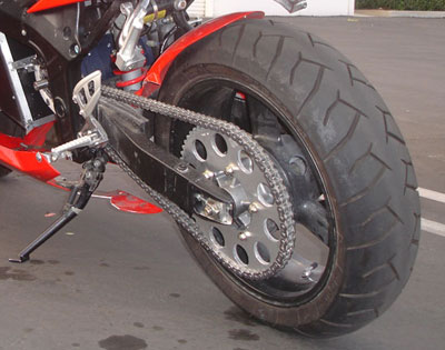

what does the 60 tooth look like on the wheel?
Like this one but the sprocket is solid. No holes to lighten it up…yet.
can’t access that picture… “forbidden”
Snap a quick picture of yours on the bike.

It’s off this guys blog.
http://www.whybike.com/blog/index.php?cat=5
