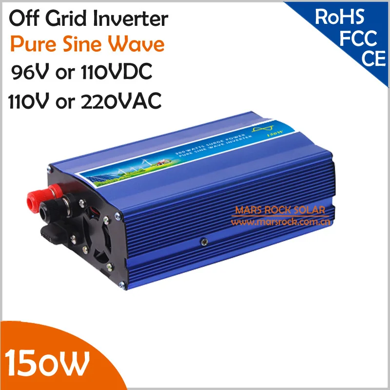

Now if you could find a dc-ac with a wide range input.
