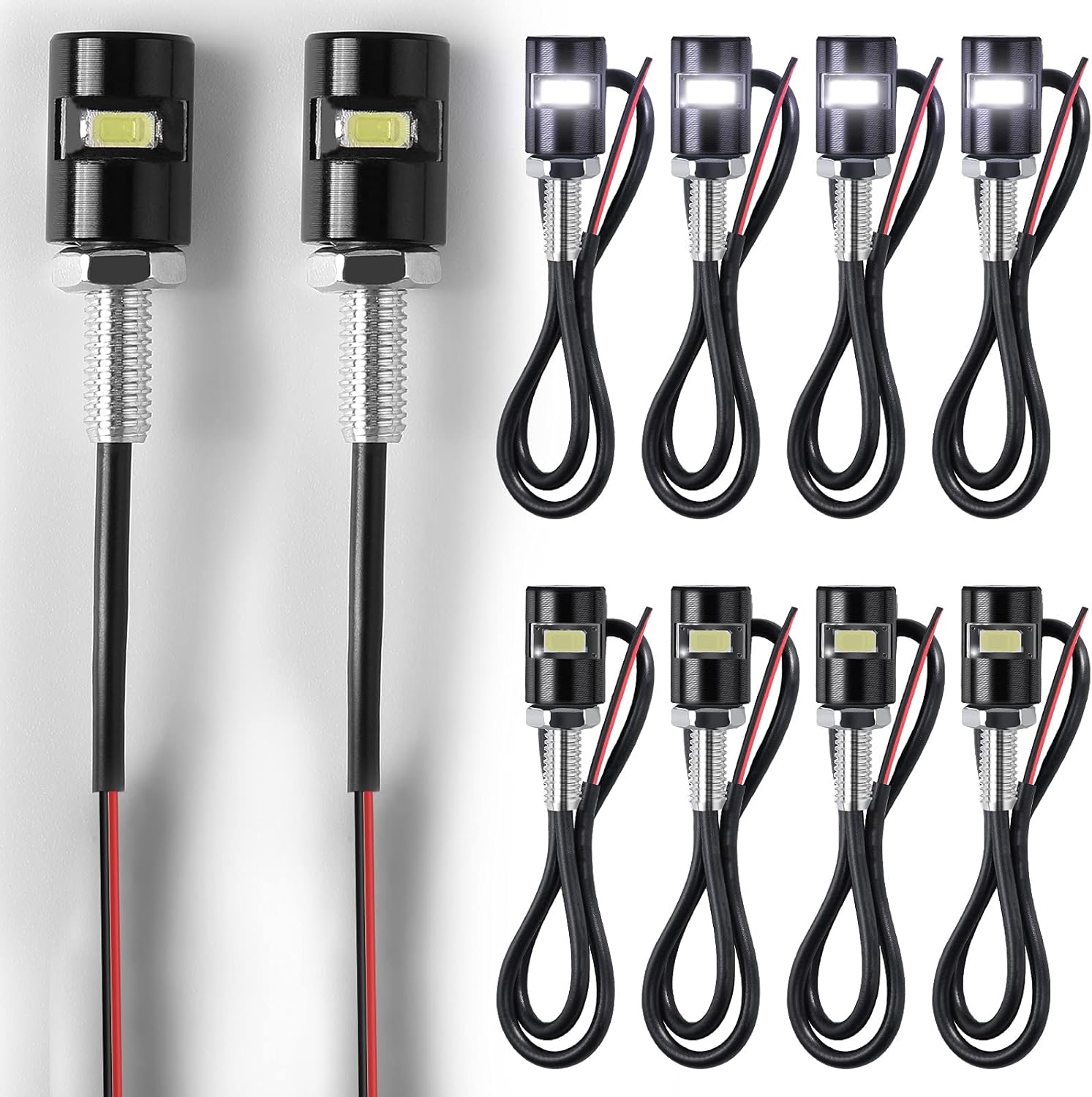

I use these for license plate light after deleting the bracket

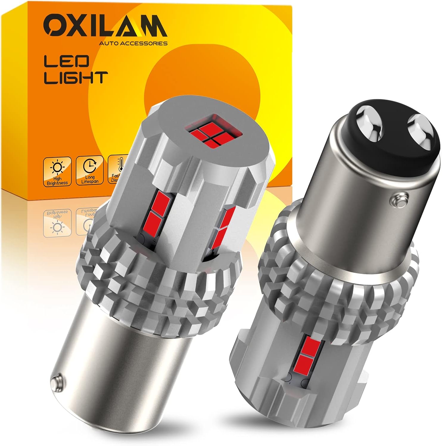

Tail (brake/turn)
swapped the bulbs out in the existing seat back (back of headrest) running & brake
Stuck an LED bulb in the license plate light, don’t recall what bulb # though.

Switched the 3rd brake light (on top of the cab) bulbs out for LED along with the license plate bulb, but don’t remember what numbers.
The current 2015 eM1400 - went with Grote semi-trailer red ovals - running & brake/turn only - 4 or 5x the cost of those crappy Partasans, but they haven’t failed. Added a Grote LED back up - don’t remember the number, don’t think any other GEM uses it. LED bulb in the license plate light and some barely legal for on-road use H4 LEDs for the headlights since they used Hella off-road rally lights that the LED upgrades are only sold in Europe at like $400 per light and the right model Ranger LED fitted hood would have cost even more
