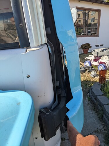

First thing MY WIFE noticed was the right rear door seemed like it was going to fall off. most of the screws holding the inner and outer shells together were missing. I will steal screws from the other doors to help hold it together while I figure out what screws I can get to fit it.

Cracked driver side inside door shell.
