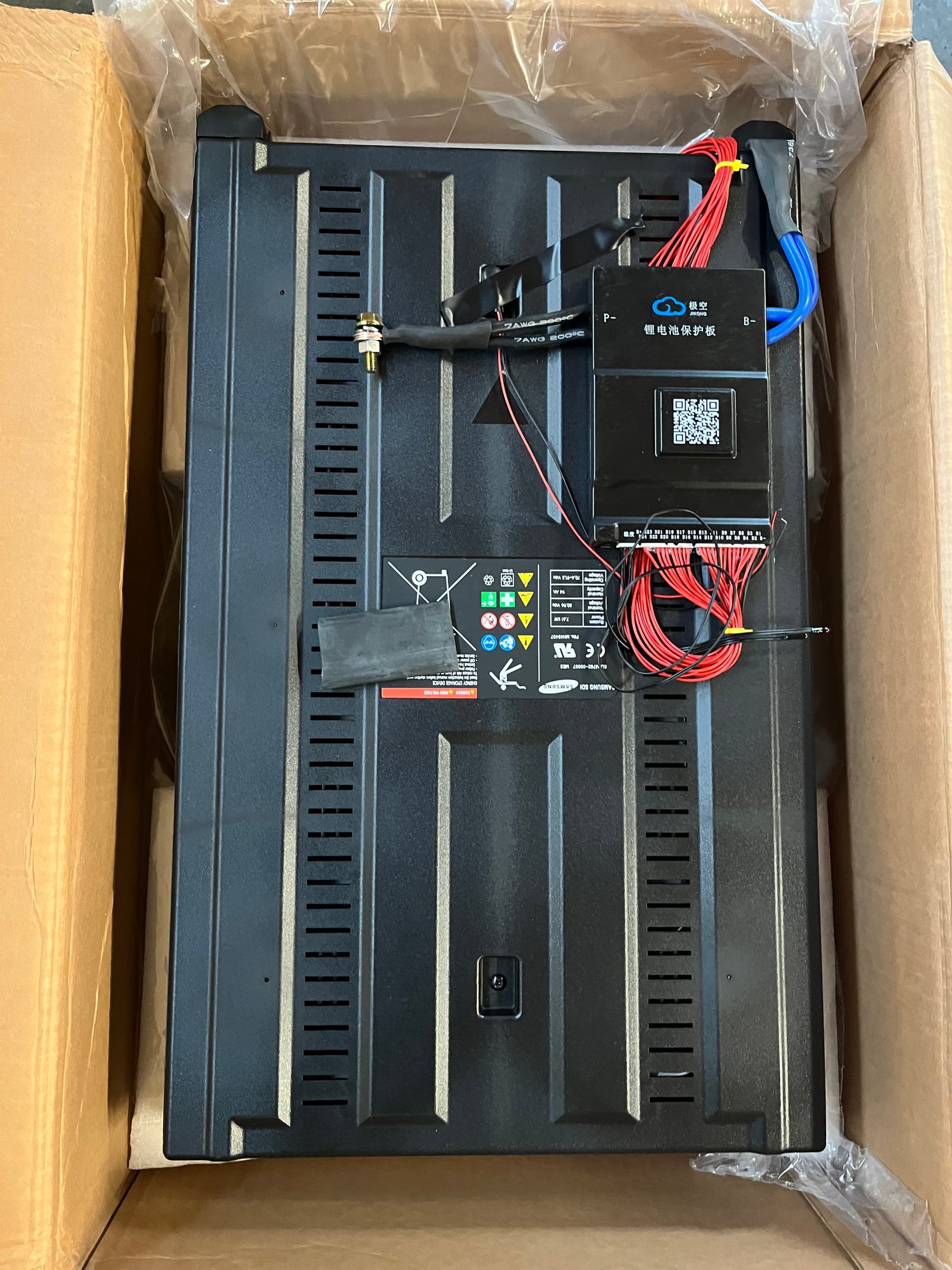

Battery has arrived save and sound and I have also received cable assembly. Thanks Dave. I there any directions on wiring install? I have downloaded the app for the BMS and it asking a password where can find that? Thanks again.
Pretty straight forward. Connect B+ wire to battery B+ and B- to the black pigtail from bms.
After connecting go to control bottom right. Turn all 3 switches to on.
Gem should run. Then plug in charger.

This is what my deck looked like (just in case you need ideas).
1/2in top deck. 3/4 supports going down to bottom of tray.
Notched in the middle to clear the cross brace in the frame. These have a slight angle taper because of the way the front goes in and down first, then the back gets dropped in.
I had to notch out the front edge a bit to clear the ebrake support (I have an e2. e4s may not have this issue?).
In reality- Most of the pack weight is straddled on the cross brace (picture a seasaw) and the front/back of the deck just keeps it from falling in on either side.
