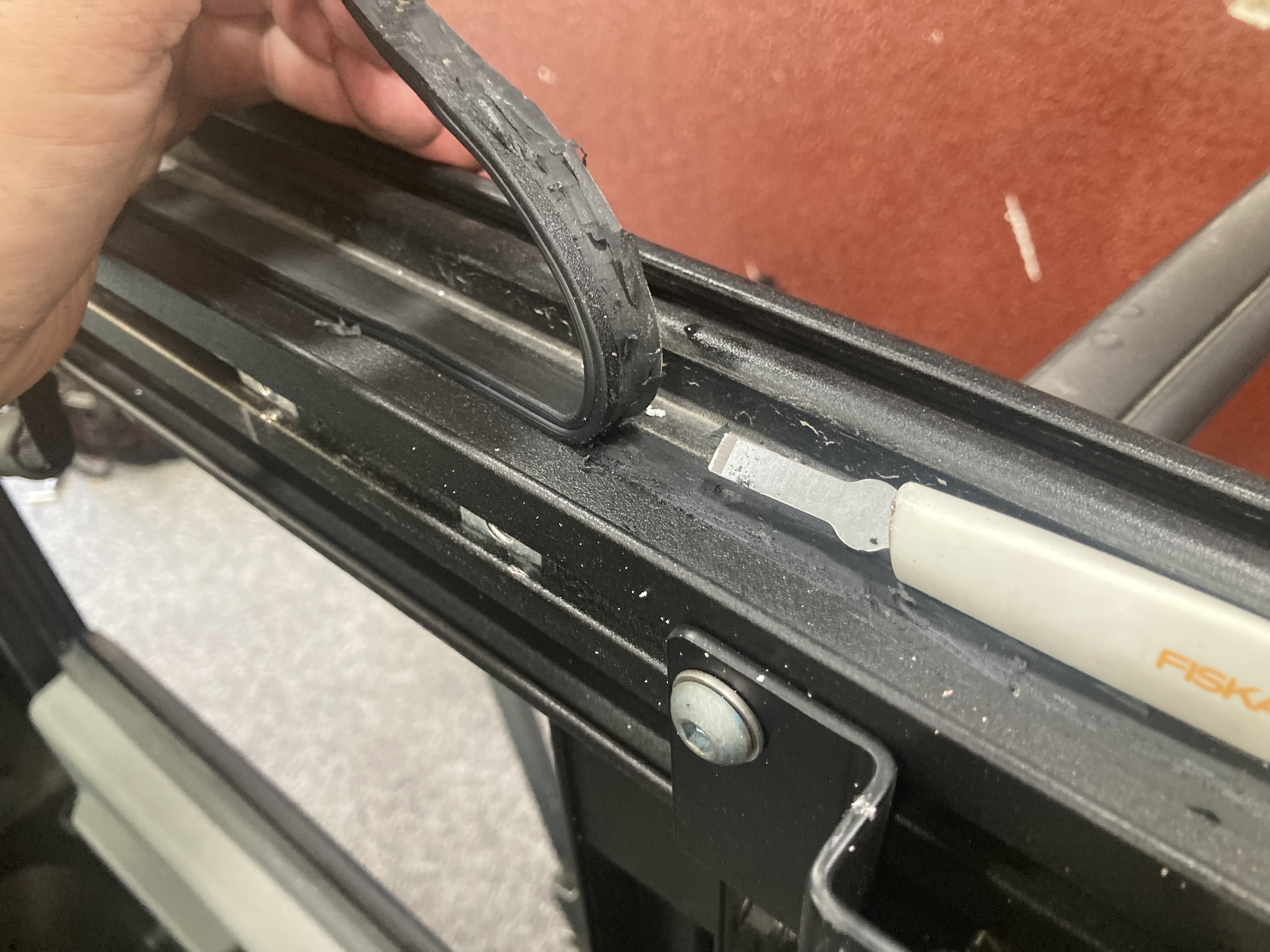

Where the roof sits or Lays into is perfectly smooth. You lay down a thick bead of urethane glue, and the roof lays on top of the glue. So the only thing your plastic roof is touching in urethane glue
Here are 2 pics of me removing the factory Glue that held the stock roof on. You can see they lay down a pretty big round beed of black urethane glue. I would say the size of the glue for reference is roughly the size, of a pencil or more glue trail
I would have the roof removed and that piece of aluminum that I circled in red in my photo removed (ground out and made smooth. The track the window lays in is flat and smooth

My 2c it’s clear that the roof was glued down over the top of a production Defect. That aluminum piece I circled in red. Is NOT supposed to be there. The roof was glued down and rocking back and forth over the top of that raised up piece of aluminum piece and it just cut or cracked the plastic roof. When you have the dealer replace the roof. Make sure they remove (grind smooth) that piece of sticking up aluminum or you will be right back in the same spot you’re in now. Let us know how things turn out.

Thanks for the pics. Strange how that piece of aluminum that’s sticking up and cause the crack doesn’t correlate with anything? It’s like a random casting flaw. Perhaps their was a Mistake in production say a (casting flaw) the parts were powder coated & then during assembly production they Noticed the flaw & tried fixing it by grinding down the defect, but they didn’t grind it flush & then glued in the roof & over the top of the casting flaw and that’s what caused your crack. That would explain the sanding marks on the inside track that you pointed out. It shouldn’t be that big of a deal to fix. I ordered 3 clear roofs from Gem Car of Miami and it only took like 2 months (the roofs were on back order) they came from WaEV (new owners of Gem) in California they were packed safe and sound on a pallet. So if you need a roof. I would recommend getting an order for a Roof going asap. Waiting for a roof is going to be the worst part of the job.
