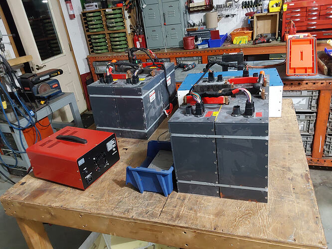

Picture of my lithium titanate Polaris Ranger battery.
240ah. Not cheaper than r4f though. More like $5k .
Snows coming. I need to get it put in.
2 sets of 120ah 20s
