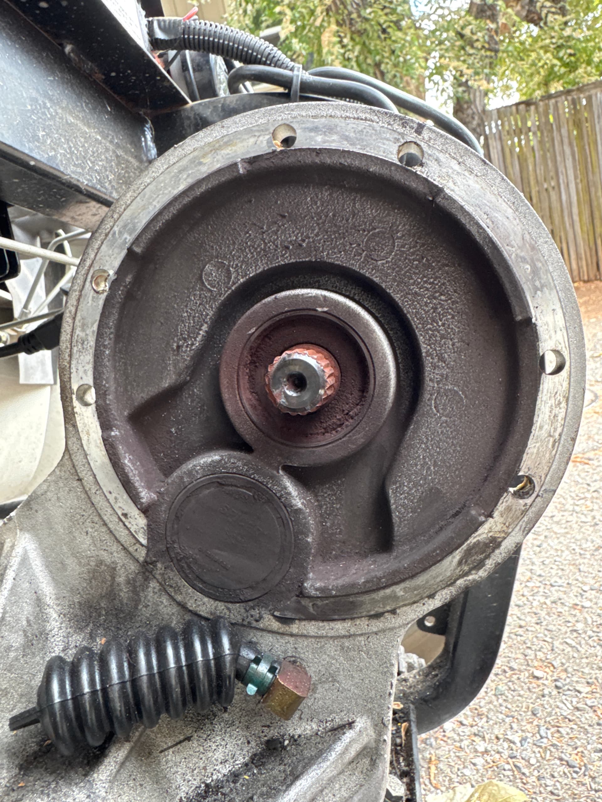

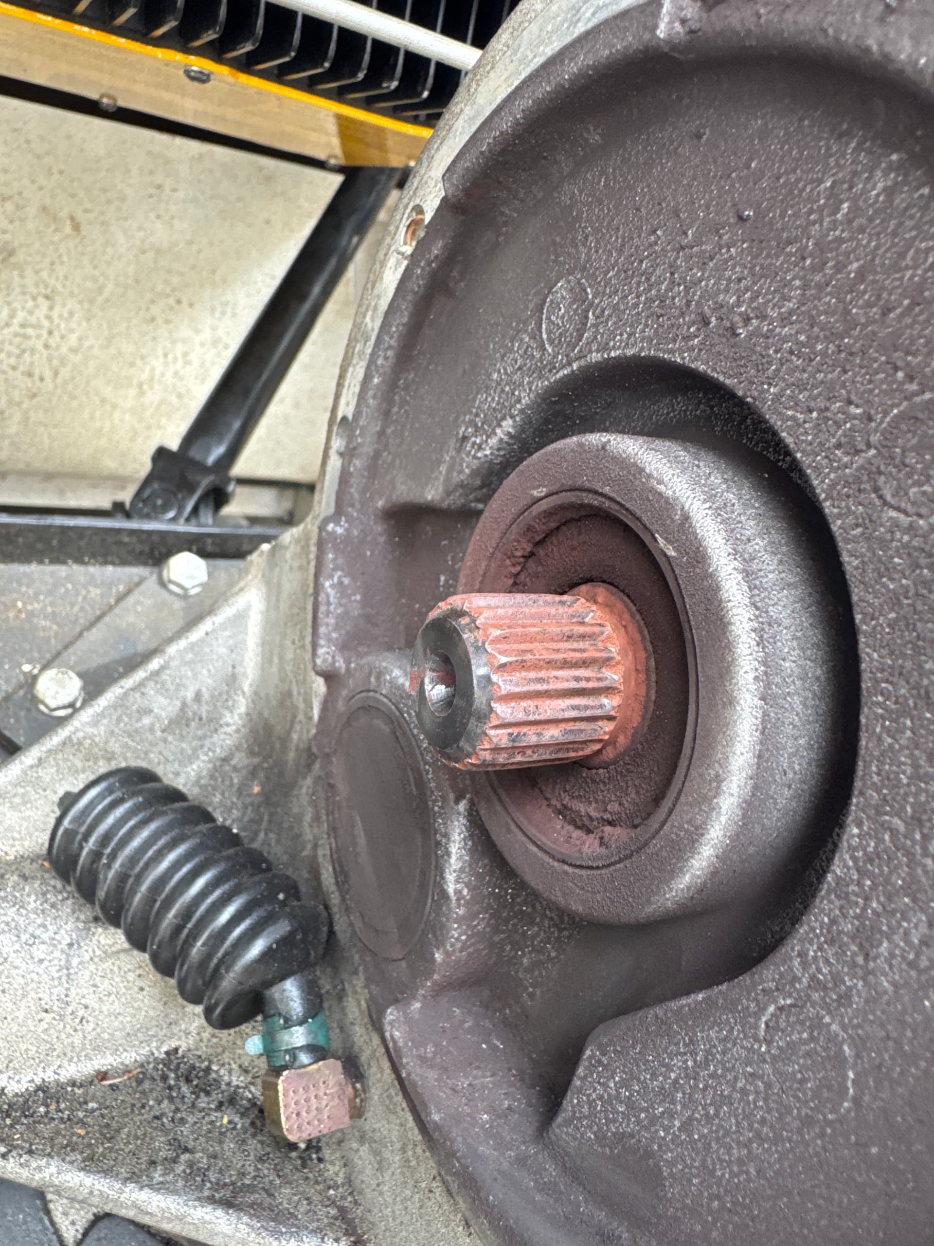

Hope so of you guys are on here now to help me out! I have the front end off, motor off. I see zero signs of an existing spine bumper, but I am curious where it will go into so I want to make sure first.
Firstly, the spline bumper is extremely tiny? Does it go in here?
Secondly, there is a slight bit of play when I move the magnet mechanism inside the motor, is that normal?
Here is the photo of the differential. All of the gears seem in pretty decent shape thankfully so I’m gonna clean this all up and wait for the response regarding the supply bumper, it looks like I need to push it into the input shaft with the motor is, but then it would essentially leave less room for the Gears to connect? Thanks for helping out this first time garage mechanic.

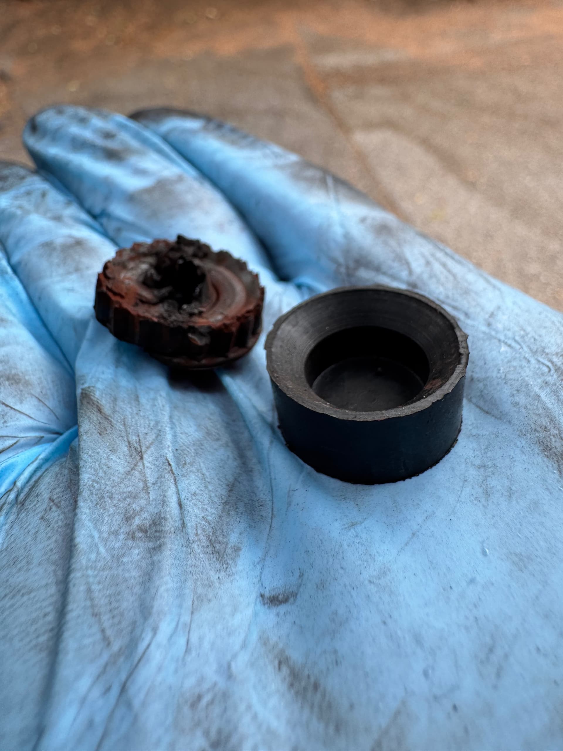

Didn’t expect a fast response so I’ve watched YouTube videos and yes, I blew everything out and got a lot of hard plastic chunks out of the motor thank goodness. Gonna pop this baby back in and slap it all together.
If I hear noise after this, I will have to believe it is the half shafts.… This is an interesting money pit
Hard plastic chunks? Can you scrounge up any of the bits for a pic?
Why would you say halfshafts? Nobody here even pointed at them.
If you look at the rpm they are turning while driving, do they make the frequency of your noise.
Instead, you might want to get another look at your input shaft. It looks very dry and worn out. Give it a dab of assembly lube (as suggested above in (post 32)).
It will help a little, but because the last guy did not, you might be looking at replacing that.

That crunchy chit in your hand next to the new bumper, that used to be a shaft bumper.
Make aure you get all of it out. If you leave anything in the collet, you’ll smoke the rpm pickup magnet and possiby the end bearing on the motor when it pushes back too far.
I got absolutely all of it, thank you!
