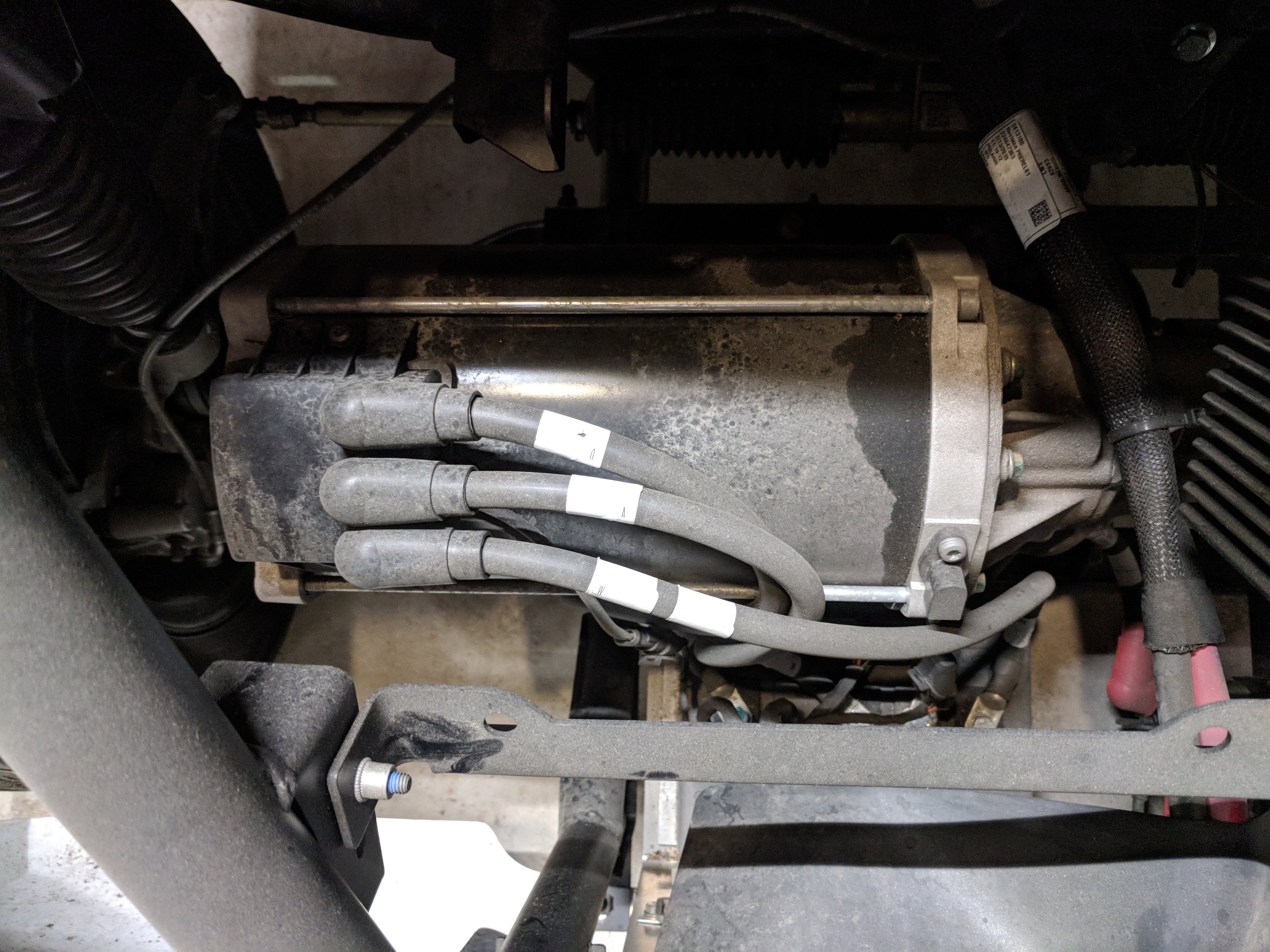

Take a picture of your motor. I’d like to see it in any case.
The MM only works on cars with dc motor and speed sensor.
Sevcon 4 36v 450a ?

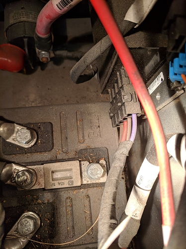

Other than the 3 heavy phase wires in the first picture, what other wires connect to the motor?
2 or 3 in second picture?

I see something like the pictured black unit you posted down near the front. I’ll get as much information off it as I can. I’m a mechanical engineer so all of this electrickery can be hard for me to keep up with
Google tells me they use a simple induction ac motor. Not a bldc motor that would use hall effect commutation.
However the output frequency of controller still controls the speed, so Polaris may limit the frequency.
An induction motor will use an incremental encoder much like the classic dc Gems.

This looks pretty sensor like to me. Sensor at the top of the image and four wire connector going to it…
The only other wires going to the motor are these and they connect under the main 3 phase cables.
That looks very hackable. Quadrature encoder. It can tell the controller the speed and direction.
Then the issue is if the controller is programmed to limit motor frequency or the sensed speed.
Not that it helps, but would be interesting to know if the car goes into limp mode or shut-down without the encoder signal.
Is that gem or gen1 on the controller?
Do you see sevcon on it. Size 4 maybe?
It says Gen 4 at the bottom right and it definitely looks like it says SEVCON on the top right but I would have to remove the leads to be 100% certain.
