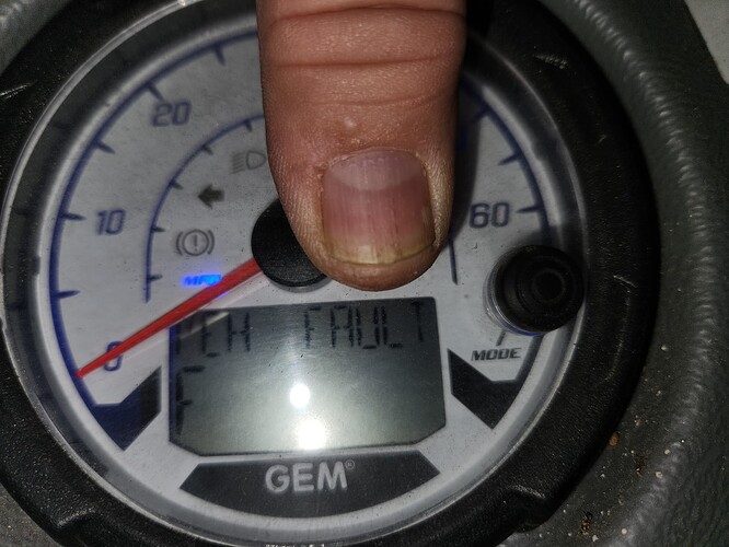

I see a wrench and a yellow triangle.
This is saying there is one or more error codes stored. Press the black rubber button and see if it will show you a code. Press it multiple times.

Also I have noticed that the car doesn’t come on everytime I turn the key on. Something activated under dash with a light clicking sound,but nothing comes on the display and it won’t run when it does this.
Also another code just popped up,says BATT LOW. Does this car have an auxiliary battery on it? I know some of these type vehicles have a small 12 volt in them for auxiliary
I found an auxiliary battery under the dash. It was defective so I changed it. Still have the triangle on the display. Anyway t9 clear the faults
See if it clears after a charge cycle?
Changing the Aux battery will probably solve this problem-
But I don’t see where you have done any further diagnostics of the main drive pack. Did you check those out and decided they were OK?
I changed auxiliary battery,and the dash and key switch work perfectly. The code and symbol are still there. Cart took a full charge also. I haven’t tested anything else. How do you get rid of the fault code
