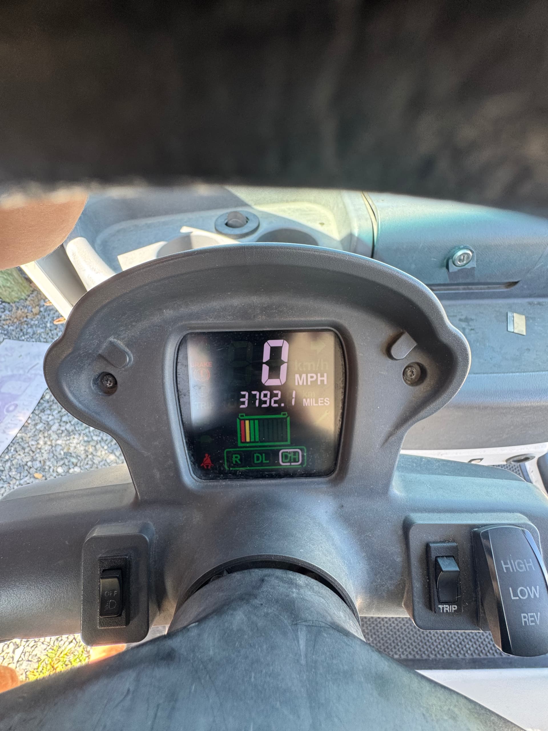

The one photo shows a black screen with the cart plugged in. It normally shows battery status and charge level here
The next photo is with the key in and turn on. This shows 2 green bars left.

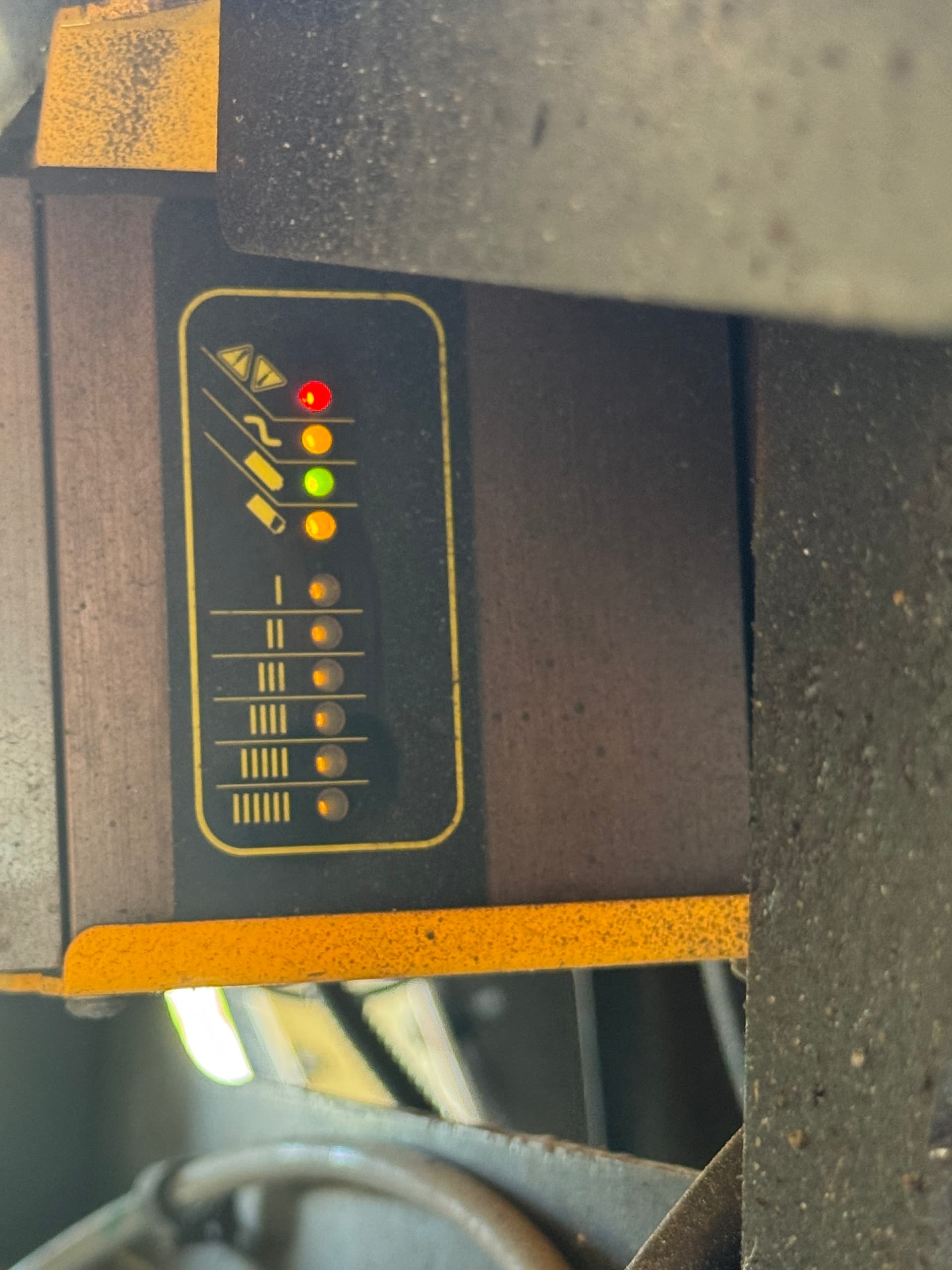

The next shows the under hood of the charger status lights, basically everything there is completely illuminated.
I was wondering what happened to you. There were many suggestions to help you out on that last fix, You claimed that it fixed itself after a 24hour sit, then you disappeared. I figured you would be back.
Looking at your problem today, It sure seems like your charger is upset at something. This looks like a charger internal logic board issue. It seems to not be performing it’s boot/self test.

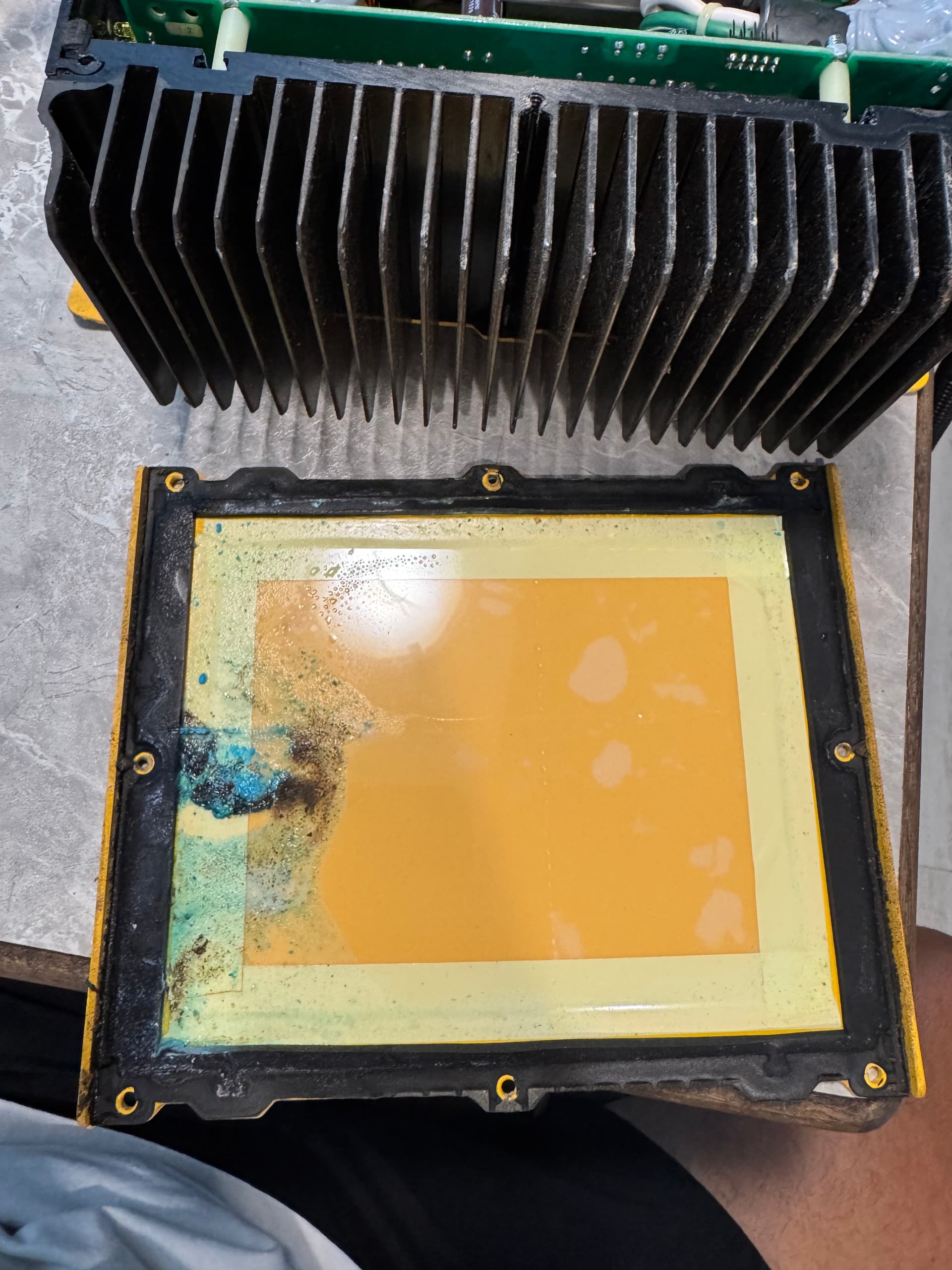

Well, I finally got time to get the charger off, but i have zero clue what am looking at, other than knowing for certain that it is wet on the inside and there is some corrosion as a result.
There ya go. It’s not as much knowing what you are looking at, but more Important that we are looking at the point of failure.
If it was clean and dry inside, I’d have you do some other diagnostics just to make sure you were heading in the correct direction.

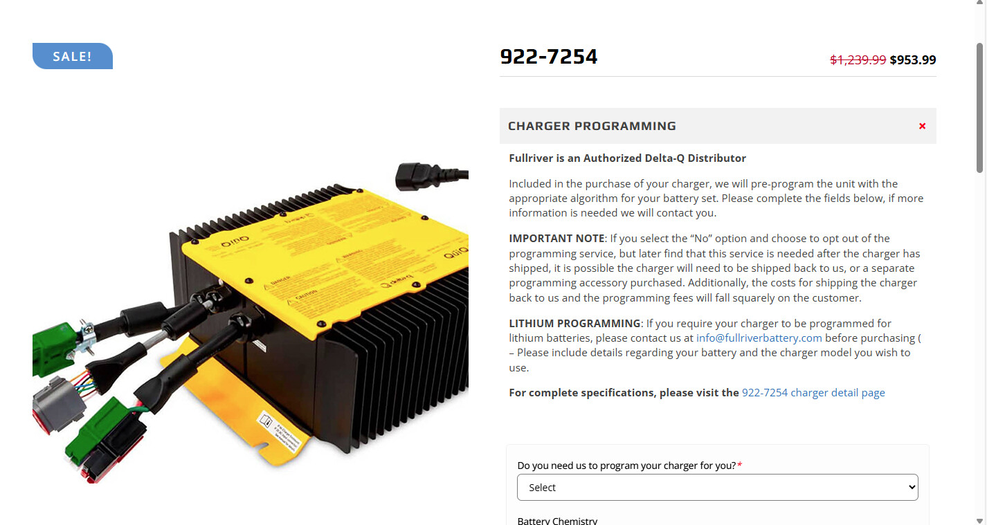

That is a very good price. Do you have a link? Picture of you charger model number?
I’m not going to steal it, but want to help you find the right charger.
You picture shows a 12v converter built in. That is called a dci model.
DQ model code should be 922-7254-etc. I’m not sure about the model number of the Polaris oem charger. Required to be plug and play.
Example from Full River Battery.
NOT the Polaris version, so not plug and play.

Well! That didnt work out! I removed the charger and sent it to Flight Systems for repair, and they deemed the charger unrepairable due to acid damage.
