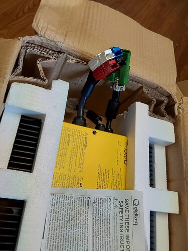

This one looks like it could work for me? All the plugs appear to match anyway!
Get the charger from dave, It will drop in and work perfect. Also If you convert to lithium down the road he can reprogram it to wotk perfectly. He is a Gem specialist so you know it will work properly. Plus he is less than half the price

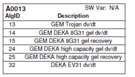

Set to #14
Sounds good, ill have to see how to set the charger once it is in. If youd like to message me we can set up payment, shipping etc
Shows high rate charge.

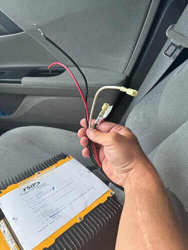

Charge will fail and set code if white wire not connected to thermistor. Original connection should be ok.
Takes a bit to get tested. Looking good so far.
These are the 72v leads.
Black to controller B-.
White and green plugged in as removed.
Red is B+. To psdm? @AssyRequired
I like Red Charge wire best on the PSDM. No need to remove that other cable you find there. Place the loop connector over the existing nut/stud and fasten with another nut. Be very careful anytime you are playing with the connections on the front of the PSDM. Those studs are SOFT and twist off quite easily.
