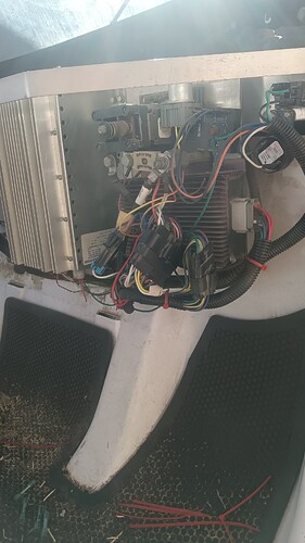

Ok this is the Motor I hope the pictures a good the new battery is tomorrow here so I have to wait
Maybe, It may have enough to work with.
Check your battery pack Volts on top of controller.
Yes I missing 1 battery I have 62v
Ok update wiring fixt new battery installed und golf car with hand moved after this checked for cods no cods test drive perfect thanks for the finding of the problem next step new charger
