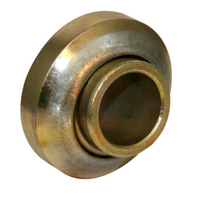

The service manual says the bushings aren’t serviceable… is that true?
