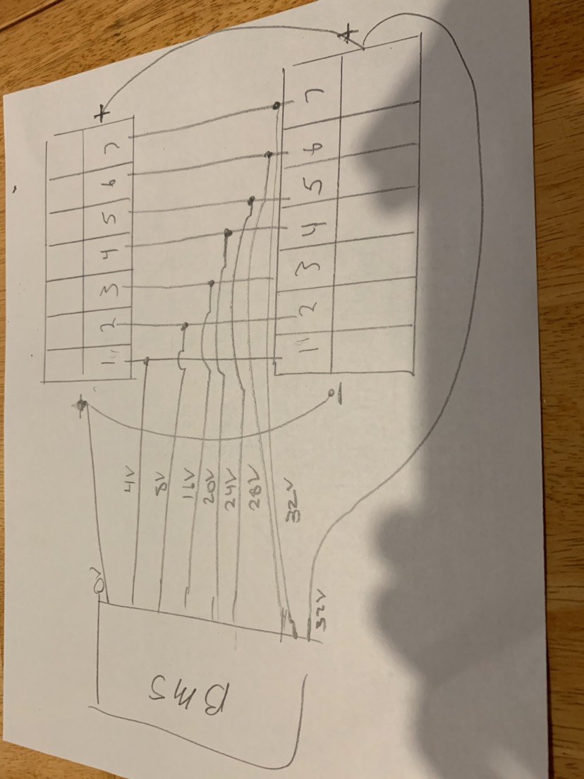

Please excuse my very, very, very bad drawing. I am about ready to install two 99v Spark batteries in parallel giving me 120Ah.
My question is should I connect the BMS leads in parallel and then to the BMS or is there a better way?
In other words, tie cell 1BMS lead to cell 1 BMS lead and then to the BMS an so on down the line.

Looks good. I don’t think it matters if you make the bms connections on one battery, then continue to the other. But tapping wire in middle may be more technically correct. Equal length.
Don’t forget to wire load inverse parallel. (that’s what plumbers call it) Plus to one battery and minus to the other. A small thing, but I think Grant reported problems with parallel lead batteries in something.
